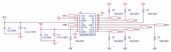

I'm testing a new board that is an AFE for conditioning the signal coming from a photodiode;
in this project I'm using the ADS1250 to digitize the analog signal;
the power supply architecture is following described:
there is a master power line coming from a switching regulator that give 12V;
the input of a TPS7A4901 is connected to the master 12V and the output of this ldo is 11V; the output of the TPS7A4901 that give 11V is connected to the input of another TPS4901 to reach 5.7V;
+VD is given by a MC78L05ACD with the input connected to the master 12V;

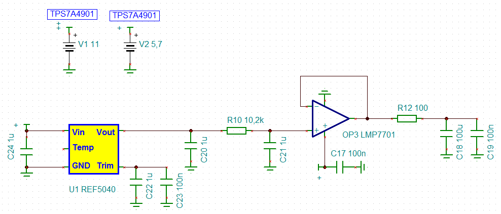

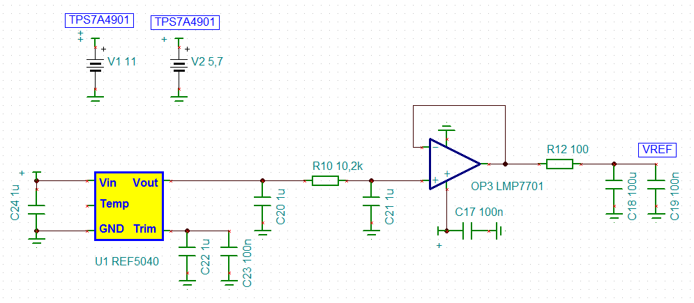

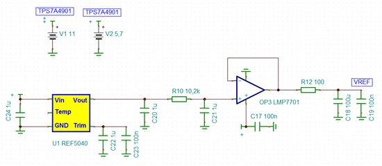

to give the reference to the ADS1250, I'm using the following circuit:
all the capacitor is MLCC, the 100uF on the LMP7701's output is tantalum capacitor;

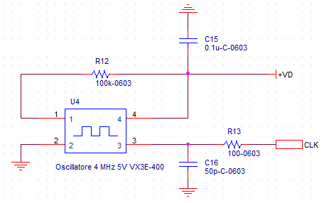

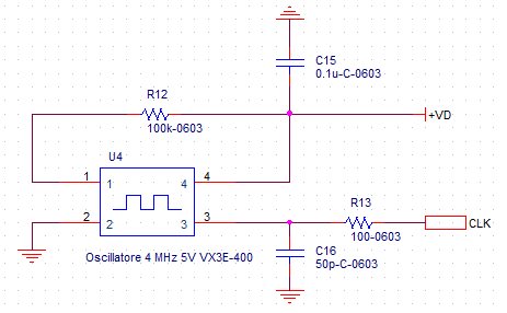

the ADC's clock frequency is 4 MHz;

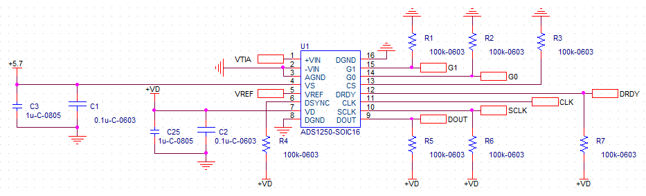

ADC, clock, reference and power supply is on the same board and an heavy ground plane is used to distribute the ground in the board;
AGND and DGN of the ADS1250 is connected together with a wide copper area in the top layer and this copper area is conected to the ground plane with a via hole

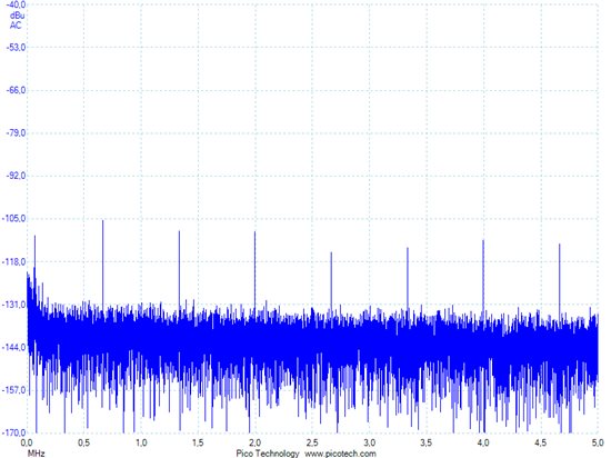

if I measure the FFT of VREF on C19 with the clock signal disconnected to the ADS1250 I obtain the following graph:

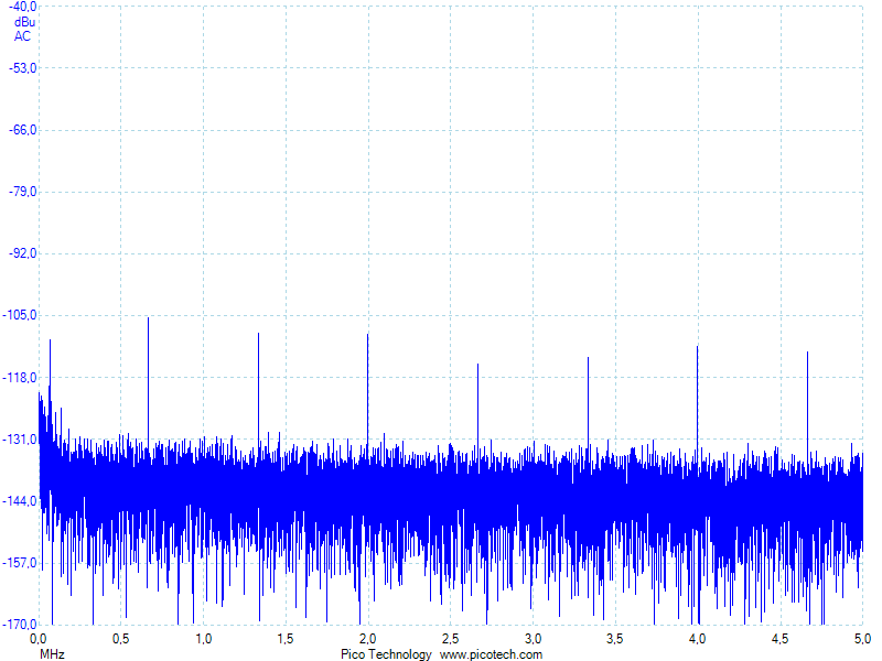

if I measure the FFT of VREF on C19 with the clock signal connected to the ADS1250 I obtain the following graph:
As can be seen from the graphs, a lot of different harmonic components appear when I connect the clock signal to the ADC;
have someone ever seen this behavior before?
I would like to kill this spurious signal because I have to reach the lowest noise level possible;
someone have the solution?

    Once you turn on the CLK, the reference is being sampled at the modulator rate.  You will see a transient as the device draws charge, and the reference replenishes.  It is difficult to say if this is really a concern at these levels.  The best possible performance will be with the inputs shorted at mid-supply.  This will show the best the converter can achieve.  If you can achieve the levels of performance shown in the datasheet, then the reference is ok.
    I do have a little concern with the analog supply at 5.7V.  It really should not exceed the specified value of 5.25V.  Absolute maximum is 6V.  This allows for a transient of up to 0.75V above the supply.  This gets reduced when raising the supply voltage higher.  There is really no advantage in doing this with respect to the dataconverter, as the reference is 4.096V which is the highest voltage that can be measured.

    You are very concerned about the high frequency reference noise, and more than likely this will not be seen.  What you may see is aliasing that may fold back relative to the modulator rate that will not be filtered out by the digital sinc filter.  I would highly suspect that you will have a larger issue due to temperature drift and noise as it relates to the analog input.

    1.  The transient may be better viewed with an oscilloscope.  What happens is charge is drawn at the reference input, and the op amp/RC combination is not able to replenish the charge quickly enough.  You have to be careful here to make sure that you don't load the op amp to heavily with a cap load that causes instability of the op amp so that it goes into oscillation.

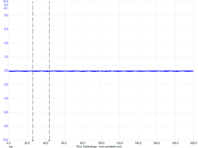

    I'm pretty sure that I don't have dc drift in the analog input because I have measured the AFE output with the scope (unfortunatelly at the moment I'm not able to post the picture mensioned; next week I will post it);
    another reason that leads me to say that I don't have DC drift in AFE output is the following:
    I have the possibility to have the scope samples in an excel file to elaborate them;
    I take 850000 samples of the AFE output and I have calculate the standard deviation of the samples;
    after I divide the 850000 samples in 16 groups composed of 53125 samples each;
    after I calculate the average of the 53125 samples for each group;
    after I calculate the standard deviation of the 16 averages obtained;
    the standard deviation of the 16 averages, is exactly 4 times less then the standard deviation of the 850000 samples;
    this behavior shows that the 850000 samples, have a gaussian distribution like white noise; if I had some dc drift, averaging the samples, would not have given an improvement like that;
    is this reasoning right?

    the AFE output is single ended: the +Vin pin of the ADS1250 is directly connected to the AFE output and the -Vin pin of the ADS1250 is directly connected to GND;
