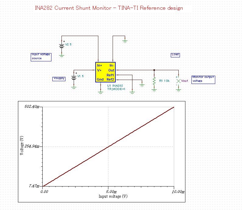

Hi all.
Please see the attached file as TINA-TI simulation result of INA282.
In this result , output voltage is 7.47mV at Vin=0V.
Why does this simulation become this result?
Could you please let me know the reason of this result 7.47mV?
INA282 specification is Gain=50V/V and Vos=20uV(typ),70uV(max).
So I calculated the Voutput(@Vin=0V) =20uV*50V/V=1mV.
                                  Voutput(@Vin=0V)=70uV*50V/V=3.5mV.

    There are more sources of offset error than those you listed; see pages 21-22 in the data sheet.  The term you are missing is likely the Rcmr term, which is responsible for the offset contributed to the error when the VREF isn't 2.048V.  In the TINA simulation you sent, the VREF lines are tied to GND.  This causes the Rcmr term to get larger.  Try taking your circuit and biasing the VREF to 2.048V.  When I did this and swept V2 from 0 to 10mV, I got 0.97mV of error on Vout when Vinput = 0.  Let me know how else I can assist.

    The Reference Voltage Rejection Ratio for the different INA28x gains is found on page 3 of the data sheet. For the INA282, you'll find it is ±25μV/V typical, ±75μV/V max, and 0.055μV/V/°C vs temperature.
    It is very easy to change the TINA circuit you have to a different reference value, attach a voltage supply set to 2.048V to REF1 and REF2, instead of GND. If you still need an example sim file, let me know and I can provide one.
