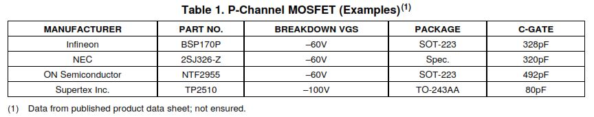

I am using the XTR111 in a Gas leak trasmitter.
Currently i have only populated the relevant parts
1)Generating 5v for peripheral use - works good
2)Vin = 1.4v
3)SET resistor 10k - output current was 1.4mA dropped across a 250ohm Load : Vout = 350mV
4)Now i change SET resitor to 2.2k so expected current was 6.3mA & Vout  should be 1.59v
Although at this point the Vout was above 8v ,
I checked pin7 (SET) for resistance and it shows a 22ohms across ground.
I dont know why it got damaged.
