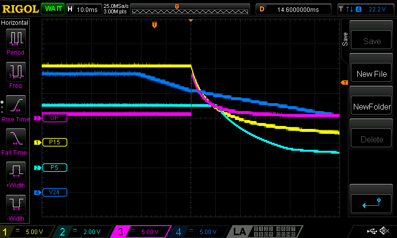

    Thanks for your reply. I managed to control the terminal voltage by shutting down the 15V regulator around 22V input (i.e. when supply to LM258 is 22V, the 15V regulator has been shut off). However, I still have the same problem where the output still goes high, mimicking the 15V rail even though the supply is higher.
    Attached scope plot shows the behaviour:
    CH3 (purple) is scoped at the output of LM258. If you look at the time when the output jumps high, the supply voltage is approx. 20V (CH4 - dark blue) and the 15V rail is approx. 14.8V (CH1 - yellow).

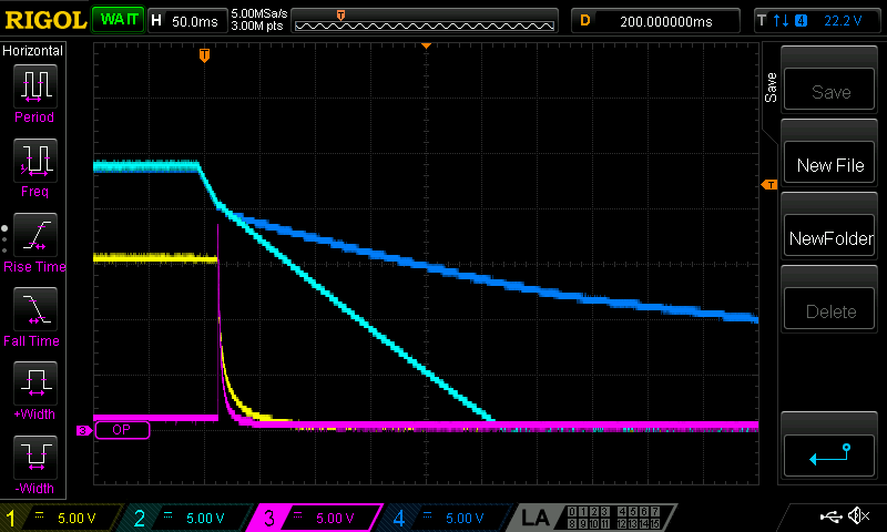

    Here is another scope plot of showing the same behaviour of the opamp:
    CH1-yellow is 15V the input terminal voltage; CH2 - light blue is Vin to the board; CH3 - purple is opamp's output; CH4-dark blue is opamp supply
    All 4 plots on the same offset. As you can see the supply is higher than the input terminal voltage but the opamp output still goes high, following the input terminal voltage.

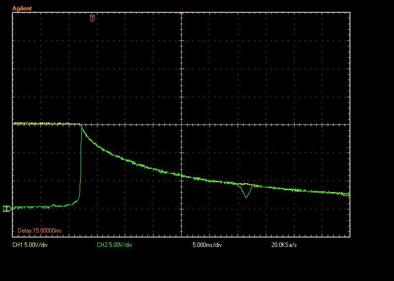

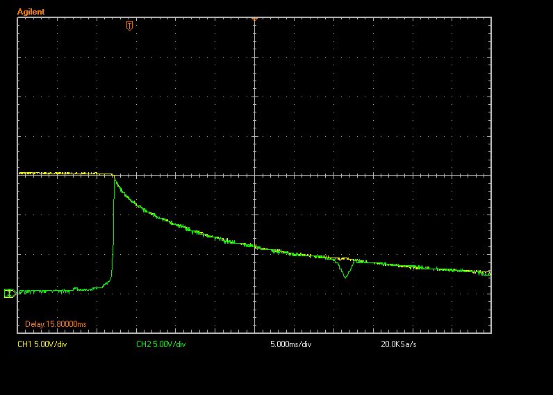

    I also tried rail-to-rail opamp that can handle the common mode voltage, LM7322 and supply it with the same terminal voltage (i.e. 15V rail) but the issue still persists:
    CH1-Yellow (15V rail: opamp supply and terminal voltage), CH2 - Green (opamp's output).
    This makes me wonder that the issue is something else than the common mode input range, which was thought to be the issue initially. Would you have any idea on where to debug?
    Samuel
  • Samuel,
    The output seems to go high a little sooner than I would expect. However, I don't think any new effect is happening.
    Because the high pulse is shorter, I think you are getting closer to a solution.
