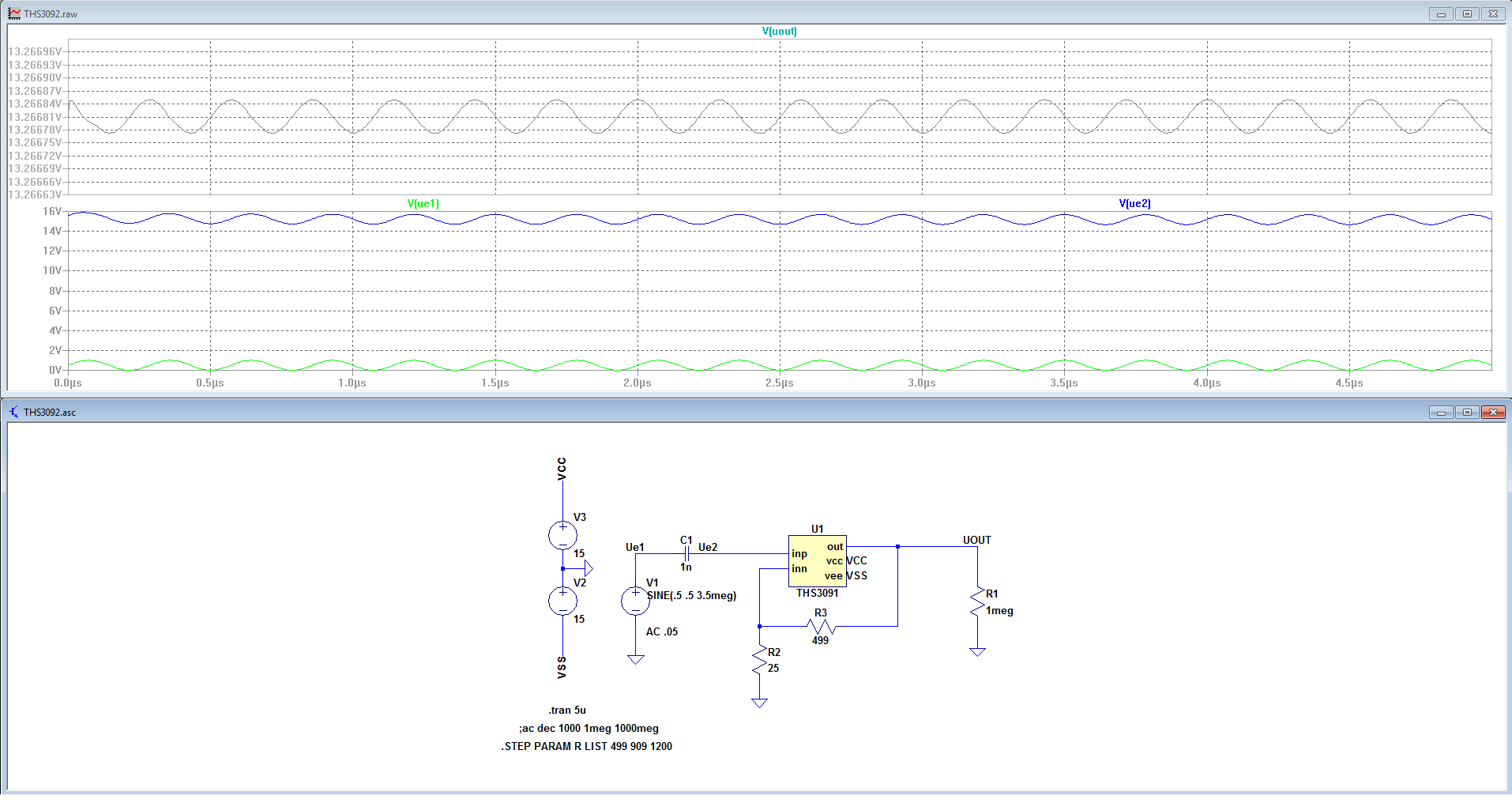

in the Datasheet of the THS3092 it says that there is a spice model for it. Where can I find that?

Another question has come up during simulation now. When I use the opamp in the non-inverting configuration it works as expected. The Signal I have, has a DC offset though. I tried to just block that with a capacitor but then the input of the opamp starts to float around 15V. I haven't seen this behaviour with other opamps(AD815). Does this have to do with the relatively smaller Input resistance (1Meg vs 7Meg). Can you think of a reason or a way to fix this? Is a pulldown-resistor the right approach?

thanks for the reply. I think I never thought about the bias current that way. I always thought of it as something going into the opamp but obviously it can flow the other direction as well. The output resistor of 1Meg was just simulating an open output, there will be a different load in my application.
