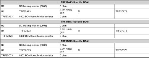

Customer is considering TRF37D73 based on TRF37x73 EVM user's guide. Then, would you provide the specific BOM for TRF37D73?
Kato
Kato
Hello Kato-san,
The TRF37D73 BOM would be:
R2 = 0 Ohms
U1 = TRF37D73
The BOM identification resistor is not necessary, and there is no resistor space for the D part.
Loren
