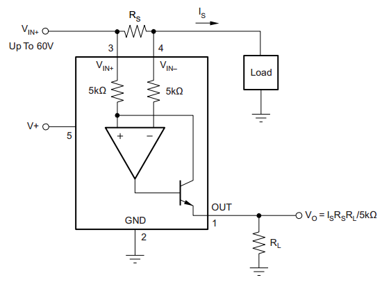

I am using the INA138 with the following setup:
Rs = 0.4 Ohm
RL = 265k Ohm
V+ and Vin+ are tied together at 6V
Load current = 250mA
I calculate that I should get an output voltage = 0.25 * 0.4 * 265000 / 5000 = 5.3V
However, I am only getting an output voltage = 1.53V
I tested this on two board.
Can you please help me understand why this is happening?
