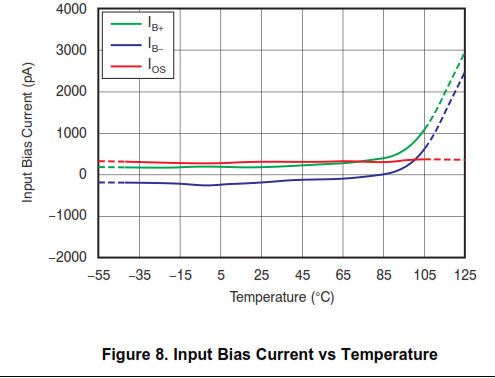

The bias current (max) value of OPA2188 was increased to +/- 18 nA from +/- 4nA at Revision C.
However, the characteristic of Input Bias Current vs. Temperature in Figure 8 is not changed.
Is this characteristic unchanged?
The customer predicts Bias Current Drift from this characteristic.
Is there a change in bias current drift between Rev B and Rev C?

    You are correct, the maximum input bias current specification over temperature was updated in the revC datasheet while Figure 8 was not changed.  Remember that Figure 8 and all other datasheet figures represent typical device performance unless otherwise noted.  Therefore Figure 8 was not updated because the performance of a typical device likely did not change, just the limits on what a "maximum" device may show.  I'll do a little research to help provide some guidance on why the maximum specification was increased.
    The dc input bias current for this type of device is a combination of the effects of the chopping circuitry and the reverse leakage currents of the input protection cells.  The leakage current of the protection cells will double every 10 degrees C which begins to dominate the response at higher temperatures.
