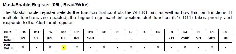

Hi Sirs,
Would you pls assist us to confirm the actual location of the BUL bit in 0x06 register? According to the datasheet, it locates at D12, however, we tried
I2C transaction “<S> <slave W> <Ack> <0x06> <Ack> <0x01> <Ack> < 0x00> <Ack> <P>” still cannot set D12 to 1. But if we changed 0x01 to 0x10, then it changed D15. Please confirm that 0x10 is for D8~D15 while 0x00 is for D0~D7. Thanks!
Thank you and Best regards,
Wayne Chen

  • Hello Wayne,
    When writing I2C data, the MSB (D15-D8) comes first and then the LSB (D7-D0). Thus if you want t write a 1'bit to D12 (BUL), then your commands should look like:
    <S><slave W><Ack><0x06><Ack><0x10><Ack><0x00><Ack><P>
    However, you say when you use the following command, D15 is set to a 1'b. How are you determining this? Could you sends terminal logs or pics of the readout of the registers before and after the write commands?

  • Hello Peter,
    Thanks for update that MSB comes first, that’s meet our experiment.
    Issuing “<S><slave W><Ack><0x06><Ack><0x10><Ack><0x00><Ack><P>” command can set D12 (BUL) to 1, so customer has closed this issue.
