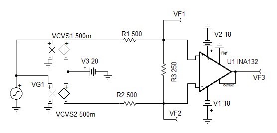

  • Hi Tamas,
    I apologize, it sounds like I misinterpreted what you are after. 75V is too large of a differential voltage to measure directly. Perhaps we should take a step back. What exactly are you measuring the voltage of and what kind of range are you trying to scale things to? Is your common-mode input voltage constant or does it fluctuate, and if it does, how much?
    There are a couple different approaches you could take here. The first is to divide down the signal to a more suitable differential level and run this into a difference amplifier. You have to be careful doing this though because the internal resistors of our difference amplifiers are very precisely matched in ratio, but not necessarily in absolute value so external input resistance could severely impact the CMRR. As long as you use precision resistors and keep the values small compared to the input impedance of the diff amp you wont degrade the CMRR to heavily. If you do this, you don't necessarily need to use a high common-mode input amplifier, you could get away with something like the INA132 like in the circuit I've attached.
    INA132 Divider Circuit.TSC
    Alternatively you could just use a true instrumentation amplifier after the divider to have a high input impedance and preserve your CMRR. The viability of this option depends on how much fluctuation you have in your input common-mode voltage.
