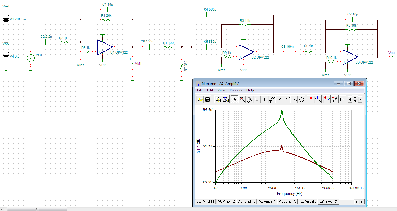

    My first thoughts are that this issue is either noise or stability. Can you run the following tests and share the results?
    * Tie ULTRASONIC_RECEIVER_B to ground and measure the output RMS voltage and peak to peak voltage. This will help us understand what the overall noise of the system is. Compare the results of a good system and a bad system.
    * Send a small pulse into the input so that we can see the % overshoot.
    Some further questions:
    * In the schematic, what is the value of C29 and C27? Are they 0?
    * What is the desired supply voltage?
    * Can you describe the input signal (amplitude, frequency, etc)?
    * How did you get a gain of 55 for the second stage? By my calculation it's a gain of 110.
    My stability analysis seems to show that each stage of the filter is stable, I've included the overall TINA schematic here for you. The overall gain of the circuit is 66,000 according to my math and TINA. If you look at the attached schematic, you'll see the noise analysis and the potential for quite a lot of noise given the high gain of the system.
    Daifuku_OPA322_Ultrasound.TSC
    A general word about noise in op-amps. We give the noise value as a typical spec, it is not guaranteed. It is possible for the silicon process to shift a little producing different values of voltage noise from lot to lot and this may be what you are seeing.
    -Paul

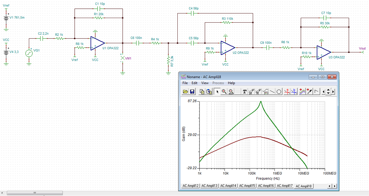

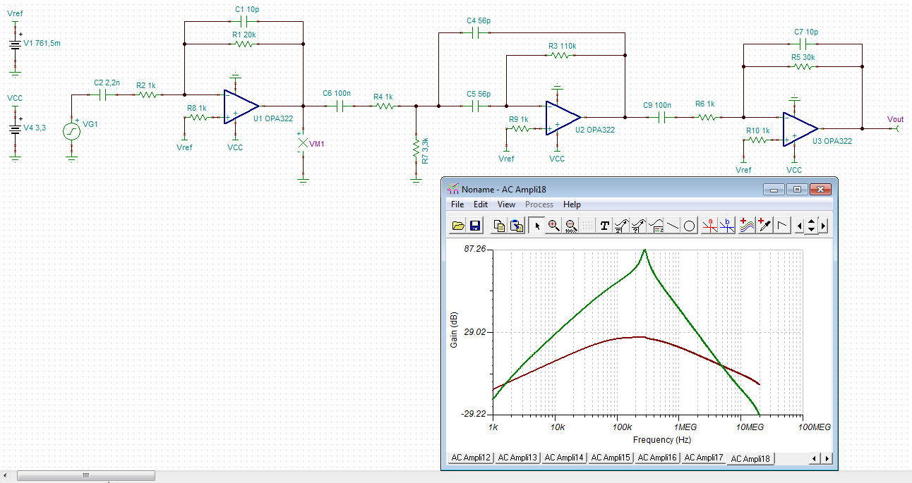

    you should redesign the filter section. I mentioned earlier that a Q=6 for the bandpass is too high. You can see this from the following rule of thumb: A single OPAmp bandpass has a gain of 2 x Q^2 at the center frequency (R30 and R33 are in parallel!). To work properly the OPAmp needs to have an open loop gain which is ten times higher: 20 x Q^2. In your case this means an open loop gain of 57dB at 300kHz. But the OPA2322 has only 37dB. This is just the gain the bandpass must provide, according to 2 x Q^2= 2 x 36 = 72 = 37dB. So, the OPA2322 even does not have any gain reserve at all.
    But there's another mistake: Due to the high Q the input impedance of U3A presents a massive load to U3B. U3B even shows a ripple in the frequency response at 300kHz resulting from this. When the input impedance of bandpass is increased the ripple almost disappears:
    I also mentioned earlier that the phase margin is considerably eroded when running the bandpass at a Q of 6. So, I would split the Q of 6 into two separate bandpasses with a Q of 3 each.
    Is there any reason why you use the voltage divider R33? This only lowers your overall gain. If the gain is too high why not lowering R21 or R22?
    Kai

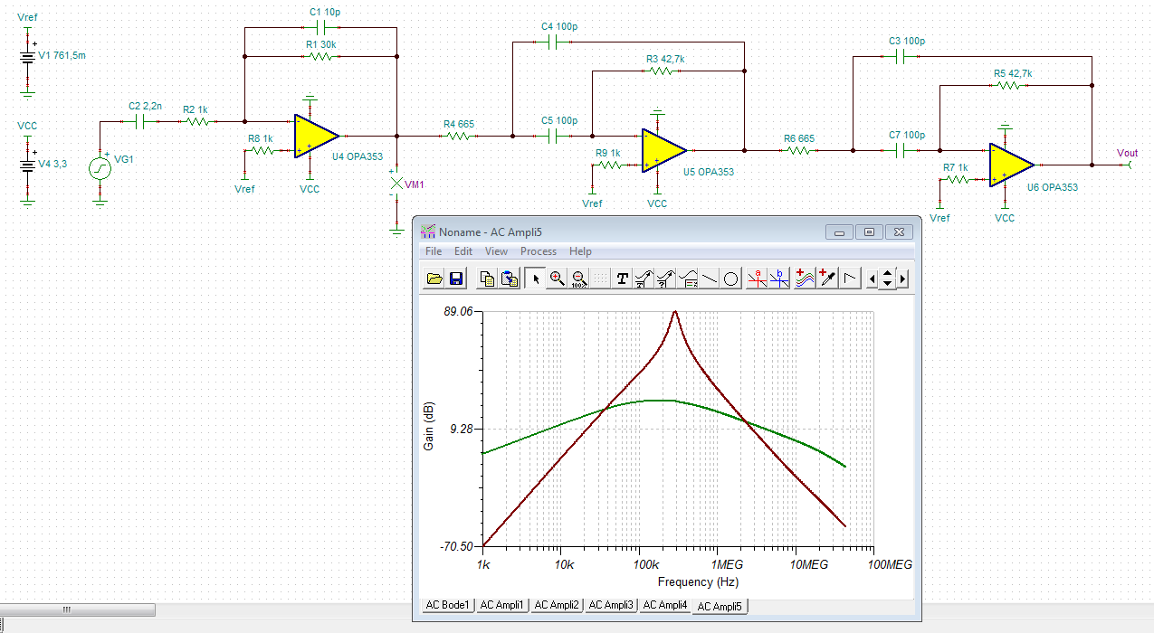

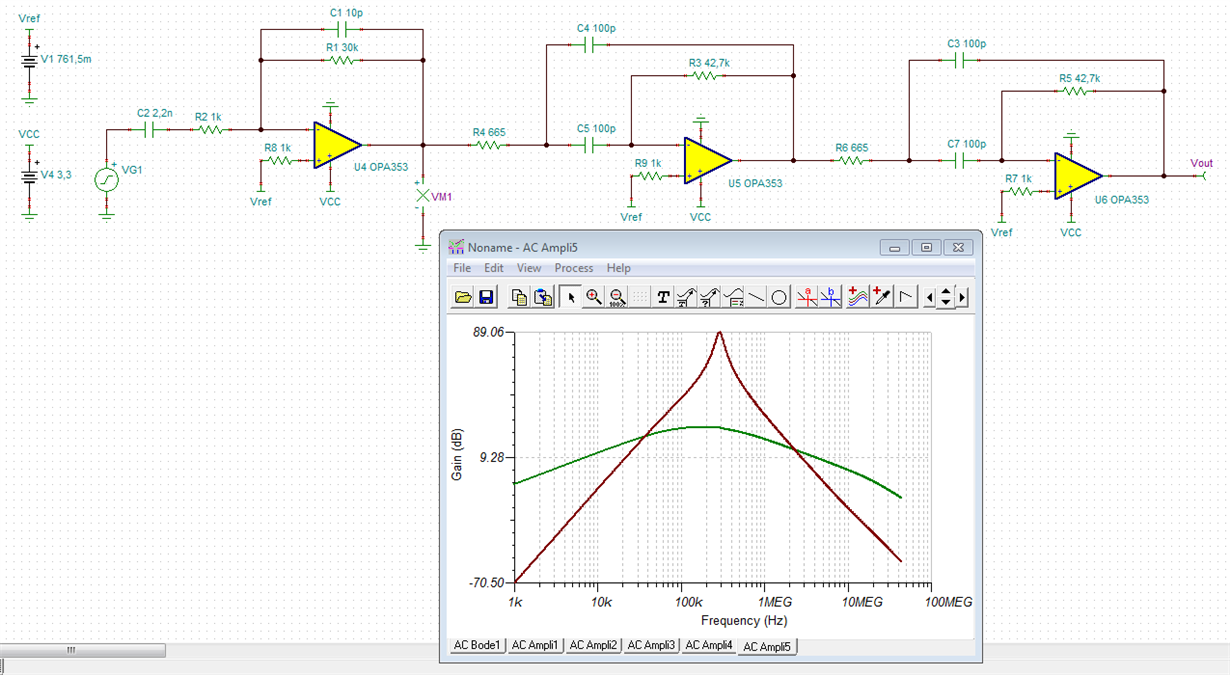

  • Hi Paul,
    yes, it's a good idea to use a faster OPAmp. I have taken your OPA353 into the simulation and it looks good:
    Of course, instead of 665R and 42k7 resistors also 680R and 43k resistors can be used. I have chosen a Q of 4 to get enough overall gain.
    A phase stability analysis (not shown here) gives a noise margin of 19° at 100kHz for each bandpass. This should be enough.

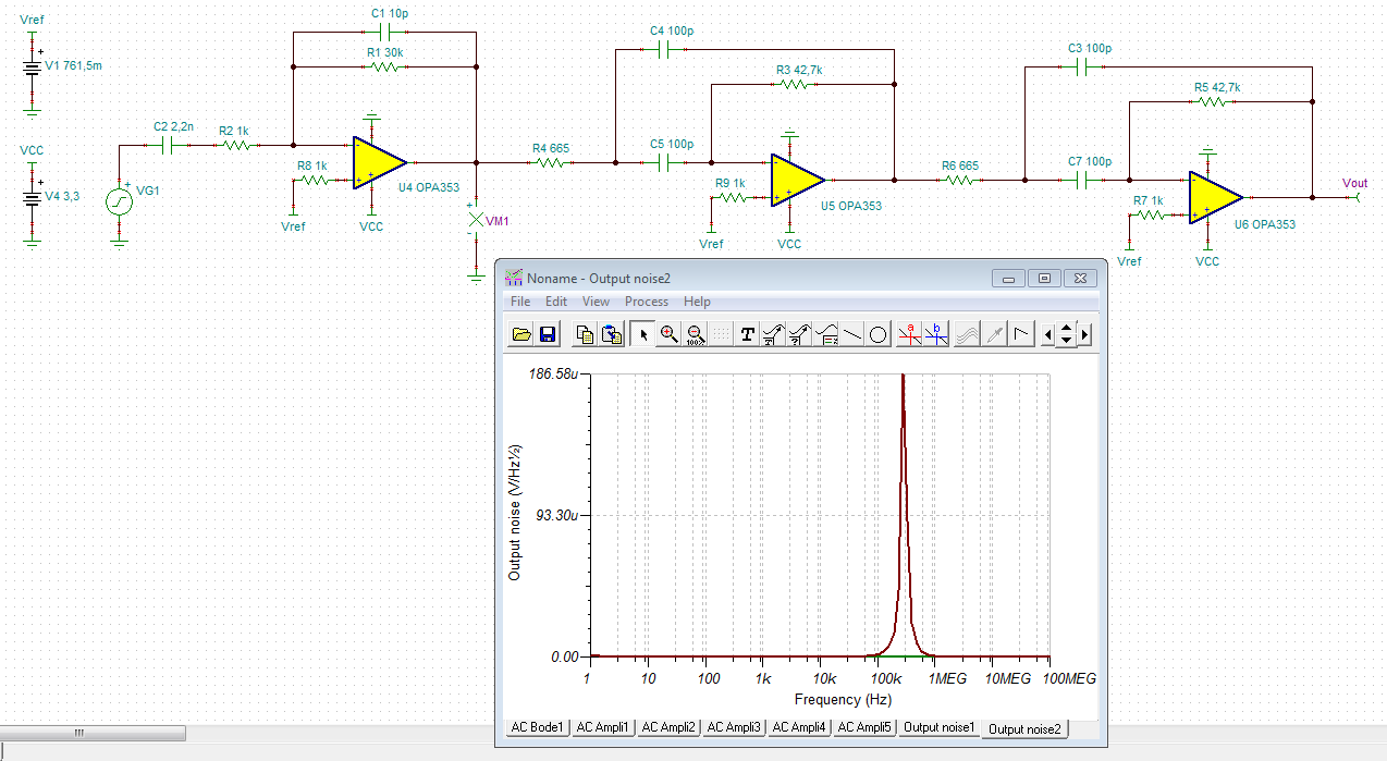

    Noise analysis also shows good results:
