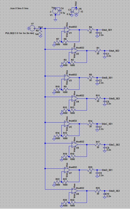

Part Number: THS4032
Other Parts Discussed in Thread: LMH6559
Hi, I am currently using THS4032 to design my ADC input circuit. the problem is i only have limited source (ATE tester resource) but multiple test site required. what is the maximum number of site i can run in parallel? Spice simulation doesn't seems issue but afraid it will affect on live circuit. attach is my circuit. what other parameter i need to check?
