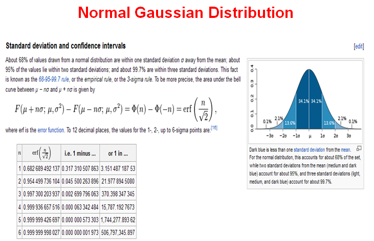

  • The voltage offset drift is NOT related to an absolute value of the offset at any given temperature but rather ONLY to a change of Vos with temperature - the steeper slope, the higher the drift.  Thus, the average Vos temperature drift in INA149 is lower between 0C to 75C (yellow line-see below) than from 75C to 125C (blue line) even though the entire Vos distribution is tighter at 125C and 75C than at 25C (see red elliptic circles) - this is a direct result of Vos being trimmed last at 125C. Having said that, as Kai mentioned, Fig 29 shows Vos drift of just handful of units and for that reason is no guarantee of a drift for any individual INA149.  For that reason, in your worst case analysis you must rely on the fact that typical drift of 3uV/C represents one standard deviation of the entire Vos drift distribution.
    This means that:
    95.4% of all units will have a drift of less than +/-6uV/C (+/-2 sigma) - 1 out of 22 units will NOT meet the limit,
    99.7% of all units will have a drift of less than +/-9uV/C (+/-3 sigma) - 1 out of 370 units will NOT meet the limit,
    99.99% of all units will have a drift of less than +/-12uV/C (+/-4 sigma) - 1 out of 15,787 units will NOT meet the limit,
    99.9999% of all units will have a drift of less than +/-15uV/C (+/-5 sigma) - 1 out of 1,744,277 units will NOT meet the limit,
    See below statistics behind Normal Gausian distribution:
