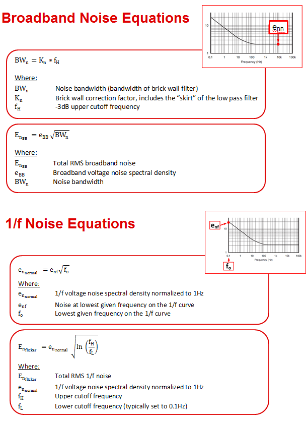

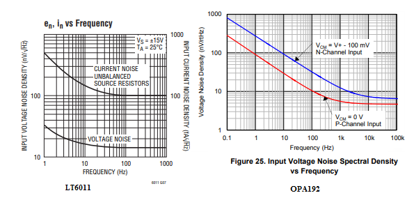

  • I do not see  so2-1 node on your schematic and you show multiple circuits using LT6011.  Having said that, total noise is a function of bandwidth and OPA192 has much higer bandwidth than LT6011, 10MHz vs 350kHz, respectively, which with everything else equal will result in a higher noise.  Also, if you are looking at one of the high-gain circuits, its noise bandwidth is very low, BW=GBW/Gain, and therefore the low frequency, 1/f, noise dominates the total noise.
    If you compare 1/f noise of LT6011 and OPA192, the former actually has lower noise - see below, and thus it is no surprise that its total noise is lower.
    Therefore, you may want to consider using one of our zero-drift amplifier like OPA188 or OPA189, which have no 1/f noise.
