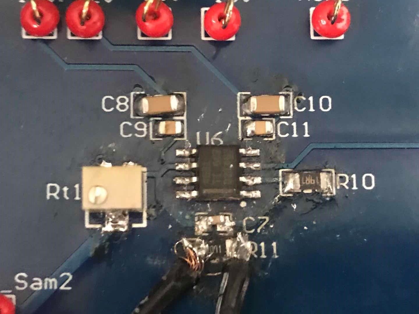

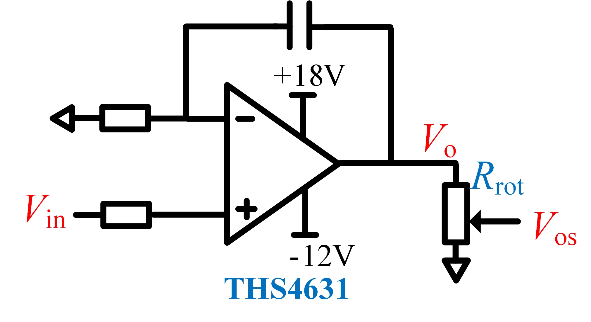

I use THS4631 to integrate a signal as fig1. And the actual PCB is as fig2. Due to power supplies, Vo will be saturated to about +18V. Since I want to compare the output with a reference by a high-speed comparator that is powered by +3.3V, I need to scale down the Vo to Vos, that is, 1/6 of Vo.

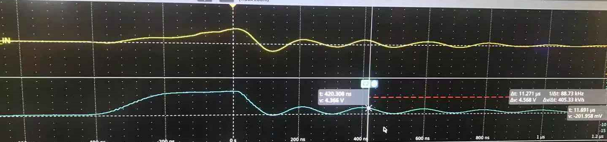

Currently, I use a regular slide rheostat as Rt1 in fig2, but Vos waveform is not good and deviates from theoretical waveforms obviously. In fig3, yellow is Vos, blue is Vo and Vo is intended to be halved . However, they don’t meet the proportional relationship.

    Not too clear from the top and bottom traces what to say. If these are supposed to be the output pin and the divided down version - it looks like the blue trace is going flat for awhile, that might be the output saturating at the rail? If so, the time to come out of saturation is not well defined and might explain your simple divider not working - also, what R values - a parasitic C in the middle of the R's could be low pass filtering giving what looks like a shift in the waveform to where it does not match the output pin/2.
  • Hi Yatao,

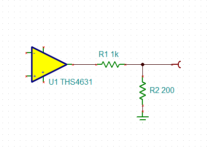

    pots are not good in HF circuits because they can suffer from parasitic capacitances, as Michael already mentioned. This is the more true the higher ohmic the pot is.
    Abandon the idea of using a pot but form the voltage divider by discrete resistors instead, as shown below:

    The blue trace is the output and the yellow trace is the divide one.And the port I use is 20K ohms.
    Yes, the blue trace is saturated to +18V.
    Before and after the saturation, divided one is not half of output voltage.

    And the divided voltage is connected to TI high speed comparator TLV3501, whose input capacitance is around 4pF by its datasheet, do you think it necessary to parallel each diecrete resistor with a capacitance? That is, use a RC network, instead of pure R network, to obtain the divide voltage?

    What value of resistors are you using to do the divide by 2. If say they are 20kohm, they will form a 10kohm source to that 4pF plus trace capacitance for a 4MHz pole - that might shift the Vout/2 waveform. You might also have a changing  load looking into the TLV3501 that is changing the divider?
    If it is just the parasitic C and the higher R's you might be using, you can equalize the response to be flat with an equal capacitor across the first resistor. If 4pF is the right number putting that across the first resistor would help in theory - This is like tuning a 10X scope probe flat.

    If I connect the TLV3501 with the divided voltage terminal, where I think the 4pF is then paralled to the second resistor, as 1k ohms in Kai's reply, do u think any modifications I should do to the discrete resistor divider?

    it's funny, I wanted to recommend the same as Michael. But with R1=1k, R2=200R and Cload=4pF the compensation cap across R1 would only be 0.8pF according to R1 x 0.8pF = R2 x 4pF. But 0.8pF is hard to install, because the stray capacitance of PCB and the parasitic capacitance of the 1k resistor itself is already in this capacitance range. That's why I didn't recommend to put a compensation capacitor in parallel to R1.
    A 20k pot at this place is way too high ohmic anyway! You can try a 2k pot instead. But to be honest, I wouldn't take a pot at all.

  • Just depends on the parasitic at the middle of the resistors, but I would try it without it first.
    I do worry a little about doing that speed up right on the output pin - now, at higher F the op amp output sees a cap load as the series combination of the two caps, would then need to test phase margin in sim.

    Yes, the compensation capactance should be 4pF*200R/1kR=0.8pF and I just refer to some materials. I find that a 0805 footprint always features 0.8pF.
    And I'll use Kai's divider.
