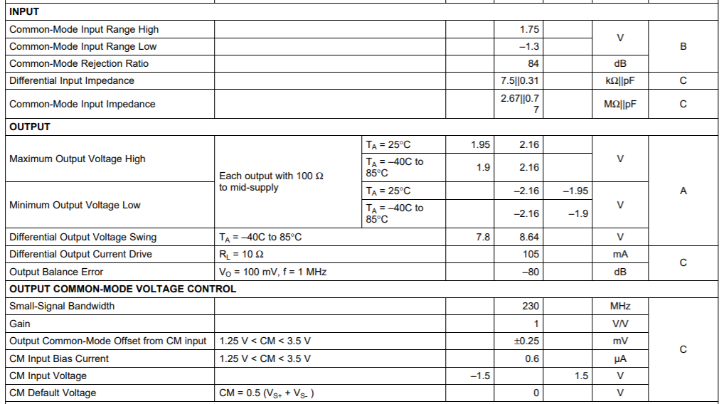

What is the VOCM pin input voltage range of the THS4520?
Many thanks in advance.
Attached here are comprehensive numbers on the TI FDA's. Down towards the bottom are the I/O swing limits cast as headrooms to the supplies - the THS4520 shows 1V required to each supply
Performance parametrics are at the top, headroom limits towards the bottom. Grouped by supply voltage range and DC precision.
