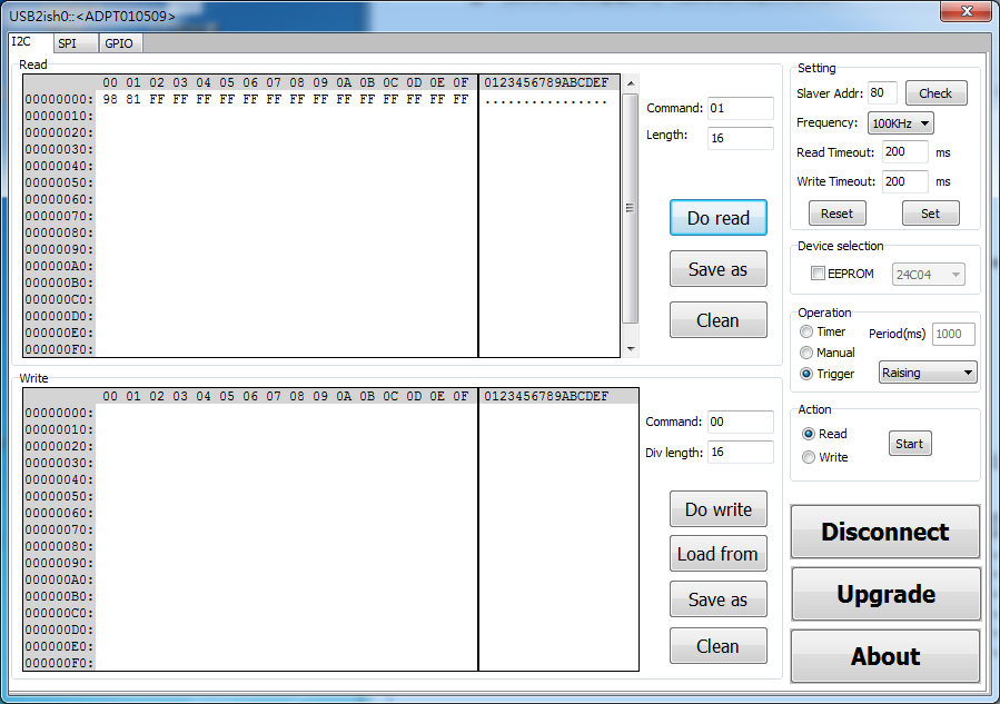

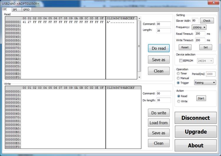

our client use INA226, and we can read 00h,01h and 02h, but we cannot to read 03h, 04h and 05h, GUI show "00"
how to read address 03h, 04h and 05h?
schematic:
INA226 Schematic.pdf
USB to I2C  Dongle   ( 00h )
USB to I2C  Dongle   ( 01h )
USB to I2C  Dongle   ( 05h )
it`s code issue?
If any suggestion, Please advise me.

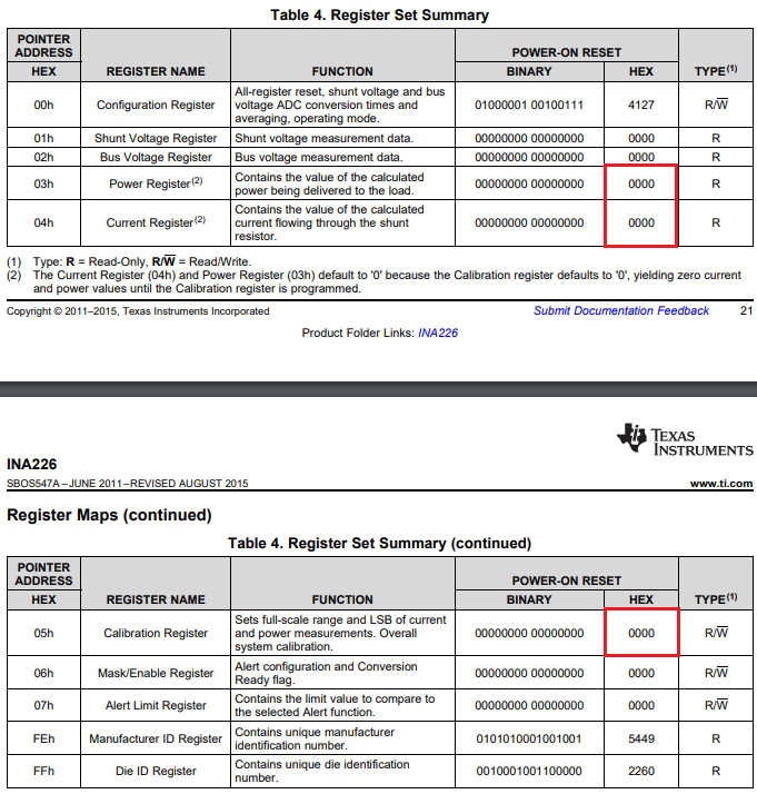

  • Hi Lawrence,
    I notice you only mentioned READ operation; did your client try any WRITE command? The reason I ask is that by default, the calibration register (05h) has a value of zero. Therefore the current and power registers (04h & 03h) will also read zero. As shown in the register map:
    In order for the current and power registers to store correct values, the cal register must be programmed. Please follow datasheet section 7.5 for instructions.

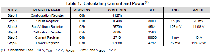

  • Hi Lawrence,
    The results are not quite right. The reason is mostly due to the selection of current LSB and Cal register values. These two are related though equation (1), they are not independent.
    Also by inspection, a 44mA current over 0.51Ohm should yield 22mV, not 140mV. This reading is not affected by the selection of Cal value, please double check.
    If the current will always be less than 100mA, you could program the Cal register to 1024h, and set current LSB to 10uA as show in below table.
    Regards, Guang

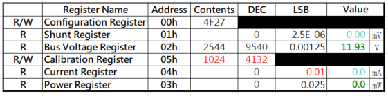

  • Hi Guang,
    I writed 1024 to 05h and set LSB to 0.01.
    Then I get the 490.3,but the actual current of this device is 40.4.
    I have to to measure every device's current value and record it .
    Such as number 1 is 40.4mA , Number 2 is 41.4mA ex .....................................

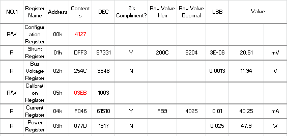

  • Hi Guang,
    I follow your instructions and list below.
    I input some parameter such as 4F27,4105 ex......... to 05H, but doesn't have a lot of change values in 04H.
    I can measure the VShunt voltage ( 19mV ), but 57331*0.0000025 = 143mV. How can I get the correct VShunt Voltage ?
    I can get the current  by Vshunt voltage( 19mV ) / Rshunt( 0.51 ohm ) = 39mA, but 61510*0.01mA = 615mA. How can I get the correct current ?
    Thanks a lot for your help !
    Anderson
    NO.1 Register Name Address Contents DEC LSB Value
    R/W Configuration Register 00h 4127
    R Shunt Register 01h DFF3 57331 0.0000025 143 mV
    R Bus Voltage Register 02h 254C 9548 0.00125 11.94 V
    R/W Calibration Register 05h 03EB 1003
    R Current Register 04h F046 61510 0.01 615 mA
    R Power Register 03h 077D 1917 0.025 47.9 W
                              Measure              Caculate
    Current(mA) VSHUNT(mV) RShunt(ohm) I(mA)=(M46/N46)
              39.9       19.9 0.51 39
  • Hi Chiang,
    You’re actually receiving the right readings from INA226. The shunt voltage and current registers use two’s compliment format data. You happened to connect input pins such that the differential input is negative. Since MSB is a sign bit, and you need to convert the data first. I did this and here is how the table looks:
    You can also swap the input pin connections, and equally you’ll get the correct reading with your original calculation.
    For details on the data conversion, refer to section 7.6.3 of the datasheet.
    If my post answers your question, please click on "This Resolved my issue" button to benefit others who have the same issue.
    Regards, Guang
