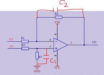

Hi expert,
I'd like to know if any ways to increase common mode signal rejection by adding these two resistors in the circuit? How will they influence the CMRR?
If they can't, is there any other ways to improve CMRR?

Hello Sheldon,
When you say "in the circuit" please expand on what the circuit you are referring to might be. A schematic would be very helpful, as well as the type of device you are using "in the circuit".

Sheldon,
Those capacitor make a low pass filter. So they reduce bandwidth. If the caps don't match then they could actually reduce CMRR.
Hi Sheldon,
the best common mode rejection is provided by the true instrumentation amplifier with three OPAmps. The common mode rejection of the simple differential amplifiers, on the other hand, usually suffers from the loss of symmetry caused by the manufacturing tolerances of the four resistors. And even with hand-selected resistors uneven temperature drifts and long term drifts will heavily limit the achievable common mode rejection. Unfortunately, the instrumentation amplifier can only show its advantage at higher gains.
