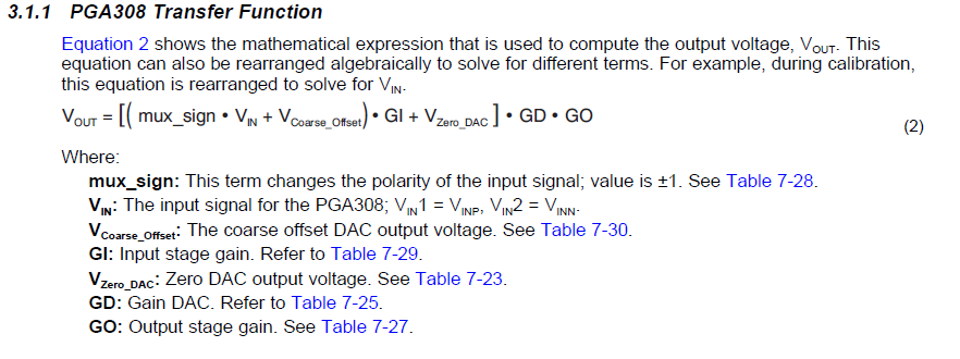

  • Hi Oba,
    The attached document details the calibration procedure used to calibrate offset and gain on the PGA309.
    The PGA309 core amplifier is similar to the PGA308.  There are some differences between the PGA308 and PGA309:  the PGA309 uses an external EEPROM, it also adds over temperature calibration and linearization of the sensor; there are also some differences in the Gain settings available and the internal DAC ranges of the device.
    However, the transfer function of the PGA308 and PGA309 and the calibration algorithm for course offset, fine offset, and selected gains is the same.  Below is the PGA308/PGA309 transfer function dependent on the coarse/fine offset DAC settings, input/output stage gain settings and Gain DAC settings:
    Please refer to the attached pdf document which details how the gain settings, offset DAC settings are calculated on the algorithm as the minimum and maximum pressure signals are applied during the calibration process.  Step 13 on the attached document does not apply to the PGA308, since the PGA308 does not incorporate a temperature look up table.
