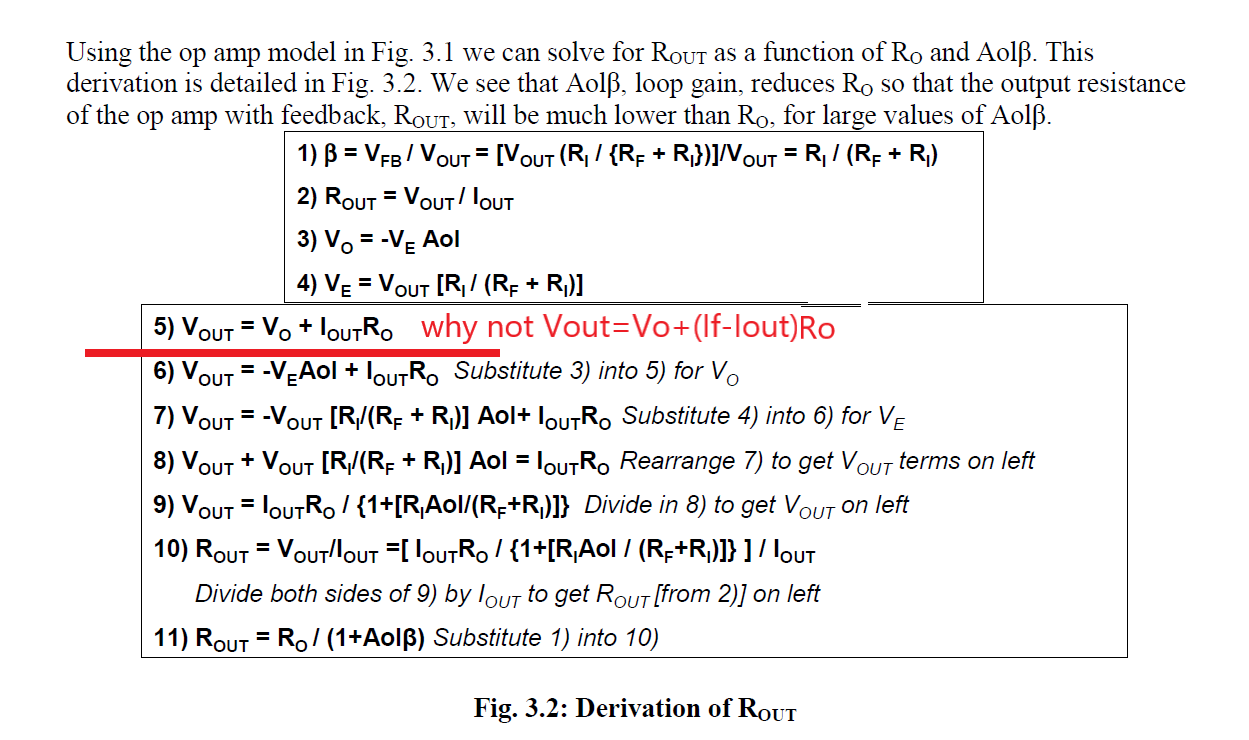

Why If is ignored in step 5 of Rout derivation?

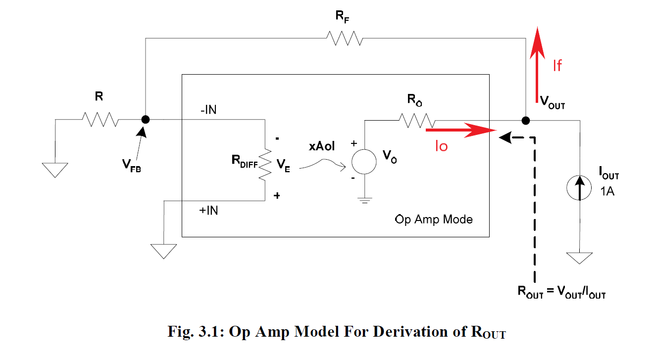

Hello Amy,
The feedback current does flow through Ro, however this is usually insignificant. The feedback load is generally a very light load compared to Ro. Because IOUT doesn't change VOUT much, the current change in feedback path changes very little. It is not worth complicating the formula.
