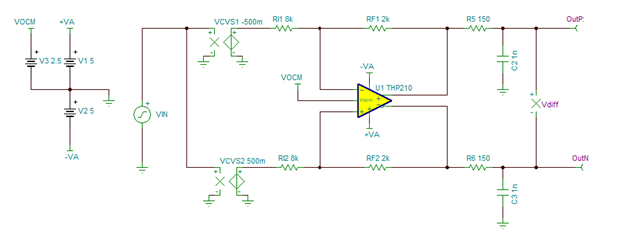

Whether THP210 shall be used to attenuate signal at 0.25 gain by adjusting feedback resistor?
For attenuation whether any specific config is required
I gone through the datasheet, the unity gain FDA it recommends to use 2Kohm. Shall I use 1Kohm instead of 2Kohm.
If I use 1K what will be the impact. Request you to provide the solution for these queries.

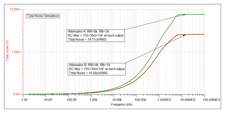

    The best approach to decide on the feedback and input resistor values for your application is to perform a quick total noise analysis of the attenuator circuit per the application noise, bandwidth, current consumption and input impedance requirements.  The THP210 TINA SPICE model can be use as a quick way to check the total noise, bandwidth and current consumption of your circuit so you can make a quick comparison.
    For example, the attached simulations for a very simple 0.25V/V attenuator(A), using RIN=8kΩ and RF=2kΩ with single-ended RC filters of 150Ω +1nF at each output offers a total output noise of ~15.04-µVRMS with a bandwidth of ~1MHz.  The load circuit seen by attenuator (A) is 10kOhm at each output.
    Attenuator(B), using RIN=4kΩ and RF=1kΩ with the same single-ended RC filter load at each output has a total noise of ~10.58-µVRMS with a bandwidth of ~1MHz.  The load load to each output is 5kOhm.

    With fully differential op amps such as the THP210 an attenuator is easily achieved by setting each side of the amplifier up as an inverting gain amplifier having a gain less than -1 V/V. For the gain of -0.25 V/V (-12 dB) the input resistors just needs to be 4x the RF resistors. If each RF is set to 2 kΩ, then quite obviously each input resistor needs to be 8 kΩ.
    The THP210 is characterized throughout the datasheet with each RF = 2 kΩ, and a differential RL = 10 kΩ. Although you certainly can reduce the RF resistors to 1 kΩ, and then make the input resistors 4 kΩ the electrical performances can vary a little from what is listed in the Electrical Characteristics table and Typical curves. If you chose to do that the total resistive load on each THP210 output will be 5 kΩ, and that is in addition any differential load resistance and/or resistance to ground off each output. The THP210 outputs can drive up to about 15 mA each, but output swing to the rail becomes more reduced the more heavily the output is loaded (Figure 6-24. Output Voltage vs Output Current). Certainly it is best not to load the outputs any more than is needed in most any op amp circuit.
