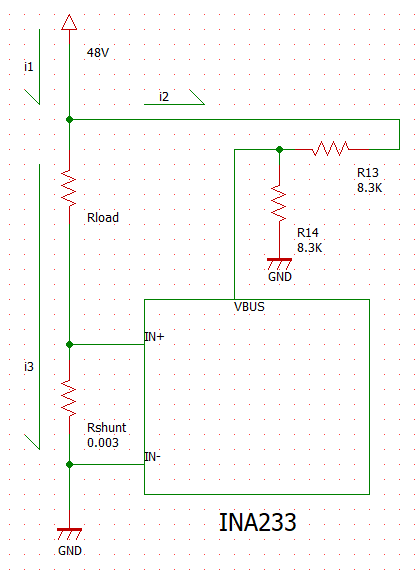

I'd like to use the INA233 to monitor the current and voltage of 48V motor. I understand that the maximum voltage input on the VBUS pin is 36V.
My intention is to add a voltage divider to reduce the input by a factor of 2, such that VBUS will be at a maximum of 24V for my full scale (48V) input. I can see that this will impact the INA233's power calculations, though for my application I am only interested in voltage and current measurements and I can correct the voltage measurement in software to account for the voltage divider.
Does this seem like a valid approach or could there be some other factors that need consideration?

  • Thank you for clarifying. This would be a low side implementation.
    To make sure I understand, if I follow TI's recommended circuit for the shunt resistor connection and only add a voltage divider to the VBUS pin, taking care to keep the resistance as low as possible, there could still be substantial errors in the measurements?
    Specifically could I assume that the current measurement would be unaffected (remaining accurate) and only the voltage measurement would be subject to errors?

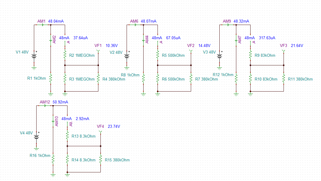

  • Hello Charma56,
    You will have bus voltage errors and if you are trying to measure all of the current sourced from the bus, you could potentially have a substantial current measurement error.  Below I illustrate the point.  For my scenario, I assumed the load is 1k ohm for the line you are measuring.  For large divider resistors (1Meg ohm), the current through the shunt line is only a little smaller than all of the current sourced from your bus supply, while the voltage seen at the device VBUS pin is nearly half (10.36V) of what you want it to be (24V).  For smaller divider resistors (8.3k ohm), the bus voltage is about what you want, however the divider is now siphoning away almost 3 mA of your supply's current.
  • Thank you for the explanation and the excellent diagrams! I get your point about the current consumption of the voltage divider.
    Regarding the current measurement error you mentioned, in the following schematic I am only interested in measuring the current across the load, i3, as shown. Will I be able to measure it accurately with this configuration? I understand i2 will be around 2.92mA in this case.
  • Hello Charma56,
    That configuration should be fine as long as you are not trying to measure ultra low currents. Ultra low would correspond to currents where your voltage across your shunt is near the INA233's max offset voltage (10uV) or lower. At those levels, your accuracy can become significantly worse without calibration.
