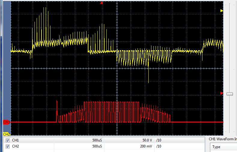

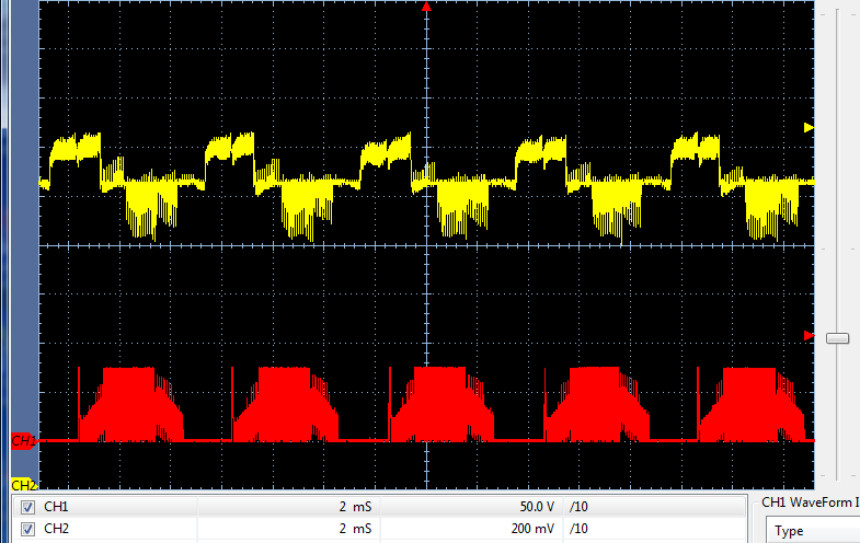

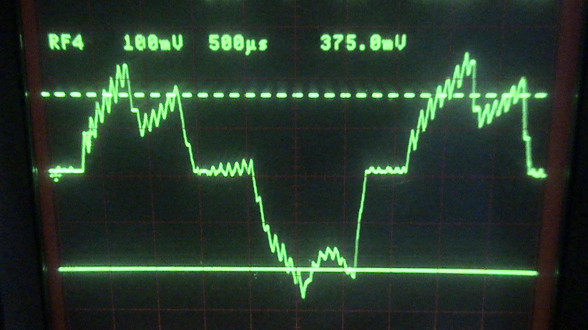

We are using the INA240-A2 in low side monitoring with +3v3 VS and the output is not symmetrical with trapezoidal waveforms being monitored. The PWM noise reduction seems better than INA282 in the same test circuit. Yet it would seem PWM rejection is not rejecting any such thing as 12.5Khz PWM pulses are very present on the output. It would also seem datasheets transient analysis differential IN+/- pins using a sine wave does not prove PWM rejection is even possible. Why datasheet have no graphs showing actual PWM rejection on output as only a square wave IN+/-, not an actual PWM signal to prove rejection?
Forward positive current flow produces a somewhat monotonic output rise using 1.225v precision reference LM4041-N, REF1/2 tied together. It seems it can not produce a proper ratio metric or linear output rise from negative current thus produce (single) pulses in opposition to forward current having rise from 0v up to trapezoidal positive current peaks. The output signal losses symmetry when the PWM duty cycle rises above 25%. So differential amplifier bandwidth seems to increase in gain/db relative Figs. 10/12 for PWM frequencies 12.5Khz up to 40Khz. Tina transient analysis looks nothing like the output signal being produced.
Previous testing circuits gave doubt of any proclaimed PWM rejection, we opted to add Johanson ceramic EMI decoupling cap XY2 1nf filtering on IN+/-. They made no difference in number of PWM pulses appearing on the output or the output gain exceeding well over 50 via 0.5uohm shunts. Whereas a 150 volt PWM pulse can easily produce outputs exceeding +/-2 up to +/-4v even tough VS pin has dedicated +3v3 regulator TPS735, VS pin 4.7uf/0.1uf bypass.
Why is there NO PWM rejection on low side monitoring and how can the A2 gain seem to exceed 50mv/A steady state duty cycles? Also seems excessive A2 gain error present, perhaps gain was not set properly at the factory or varies depending on the input signal type? What can we do to make the signal symmetry mirrored where SAR ADC can more easily determine ratio metric linear current rise in the PWM duty cycle?

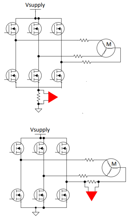

  • Thanks for considering to use the INA240 in your design. So I want to clarify, you say you are doing low-side sensing which makes me think you would have an implementation like the one shown in the first figure below. However, you then mention negative or reverse current, which suggests you are actually doing in-line sensing like in the second figure. Can you provide a basic schematic or block diagram of your setup? From there can you provide a scope shot of the behavior you are seeing and indicate specifically where you are measuring at?
  • Hi Patrick,

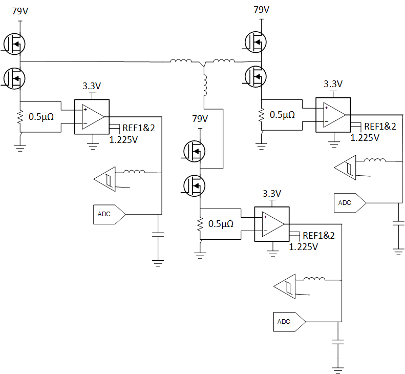

    We are low side monitoring three 1/2 bridges. Logically bipolar switching current flows in both directions. That is to say PWM in slow decay the low side FETS are mostly saturated via 90% duty cycles and current recirculates in high side FETS each 80us period (slow decay). Perhaps also it depends on inductive inrush current in each 80us period where ringing at the beginning of each period seem to indicate electron pair waves cause reverse current flow and the INA240 can not settle fast enough even @400Khz bandwidth. Our Hantek 65 current clamp produces symmetrical output in series with phase, indicates balanced current flow in both directions exists.
    So we since posting added TDK ferrite beads into the +3v3 VS source supply which seems to have stabilize the lower half of the differential amplifiers pulses. The signal is still not correct and should resemble the top half of wave. Instead the bottom part does not form bridges between pulses similar to the top half of the wave. Oddly only when the duty cycle is very low does the INA240 output produce symmetrical waves representing inductive current flow. That was the waveform behavior with or without Johanson 1nf EMI filter cap on the +/-IN or TDK ferrite beads. What else can we do to correct this behavior?
  • Hello BP101,
    Thank you for the clarification. I now have a better understanding of what you are doing. From your posted scope shots, I presume channel 1 corresponds to the voltage across one of your windings, while channel 2 corresponds to the output from one of your INA240s. After consulting with my team, we believe the behavior you are seeing is normal and will improve for lower switch node voltages. The justification for our PWM rejection claim for the part is due to the offset staying the same as the common mode changes with the output settling quickly.
    On a different note, we suspect your scope may also be amplifying the magnitude of those transient peaks you see. If you zoom in even more on the time and voltage scales, we suspect that peaks may actually get a little smaller. However, they will still be there, which I agree is frustrating.
    The possible fixes for removing those peaks include an output filter and a slower PWM. I understand that neither of these may be desirable. Alternatively, we recommend on the ADC end sampling for the duration after those transients settle. We expect the settling time to be around 9.6us. So with a 80us period, I calculate the PWM high duration as 72us and that would give you a max recommended sampling duration of 62.4us. However, a smaller sampling duration will yield even better results.
    One other thing that may be worth investigating is the layout. If you share your layout, we can potentially tell you if there are any changes we would make to improve performance. If you are uncomfortable with sharing this on the forum, we can discuss this through email.

    Sadly the +/- output spikes are present and can easily trip the analog fault comparator cutting off PWM drive. The A2 50V/V is randomly producing roughly 100mv/A with 0.5uOhm shunt and seems to reduce if the output is divided below REF1/2 voltage threshold (1.65v). Doing so requires 523R resistor to ground in output divider which allows PWM noise to plague the samples. So this time we opted to stay below 1.65v using 1.225v direct into REF1/2 with no divider on the output, producing floor threshold bit higher than the dividers 540mv floor. The 1.225v REF1/2 should produce around +83A full scale and arrest INA from spewing so many pulses below ground, that has not worked out so well. The layout is highly flexible designed for summation, first INA sets REF1/2 threshold of second. We are only using one INA and bypass 2nd via solder bridge REF1/2 pads to output pad. So the 2nd INA for summation is not populated at this time.
    Actually the PWM ringing settles within 1.5us and we fire one shot timer delaying sample window, roughly 2.5us with 1.5us conversion latency using 2x oversampling producing 1.14MSPS digital representation of the captured samples.
    7-14-18 (We trusted the ADC was capable of sampling 2MSPS but was actually 1MSPS)
    So the INA output impedance and REF1/2 inputs obviously have little noise rejection, larger part of the issue. After adding ferrite beads to the REF1/2 source regulator & output reveals a new artifact that was missing when the CMM slope changed relative to the duty cycle.
    We order the B102C/B601C may further reduce ADC input impedance and stop random spikes of IAN output from attacking MCU busses.

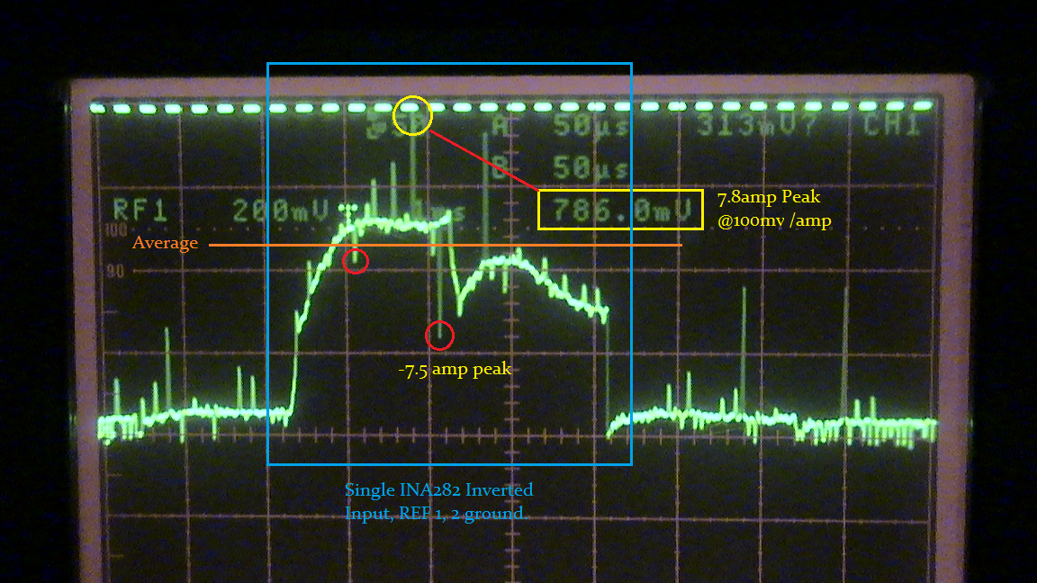

  •  The odd part is pulse peaks often seem to exceed 50v/v gain, act more like 100-200v/v gain. Again 5uohm shunt requires scope current probe 50mv/A for comparable current measures to other current measure instruments. Long ago calculated 25mv/A for *50 gain with 5uohm shunt. Also a 5mohm shunt produces more output gain, one reason we lowered input +/- IN to microvolts by reducing shunt size. These captures are not showing cyclic surge peaks occurring on the INA output often exceeding far -2v below ground and above +3v3 VS .
    These captures show the output gain is far from being 50v/v with a 5uohm shunt. It would seem even with the INA282/50v the gain was not being set as stated. Point is adding a voltage divider on the output to effectively lower the gain also effects the currently measurement. E.G. INA240A2 with 1.225v REF1/2 and 0.5uOhm shunt should produce 500uv/Amp*50gain=25mv/amp. Yet it produces twice the gain or 50mv/A and not 25mv/A as expected for 50v/v gain.

    Well these peaks (capture) represent inductive inrush current beginning of each 80us period. Current leading the voltage causes ringing in the inductor until saturation point, reason for X2Y EMI 1nf filter on +/-IN and MMZ ferrite bead on the output.. That is not NFET (di/dv/DT) or Qrr recovery since that occurs below ground or slightly above but never at peak VDS.
    Again the INA output gain is not what it should logically be for 5uohm shunt and falsely represents current measured as a micro voltage of said shunt. Also fails to produce very little ratio metric rise if REF2 is below +1.65v or REF1 GND as VS=+3v3. So the entire current measure INA240A2 is plagued in this REF1/2 1.22v configuration unless the differential amplifier output signal is divided down to 450mv with REF1 +1.65v REF2 GND. Tina transient analysis is not showing same output peaks with a similar PWM inductive load and REF1/2 +1.225v VS=+3v3. So something is really not as it should be and from my experiments it seems the amplifier gain is not being set correctly at the factory.

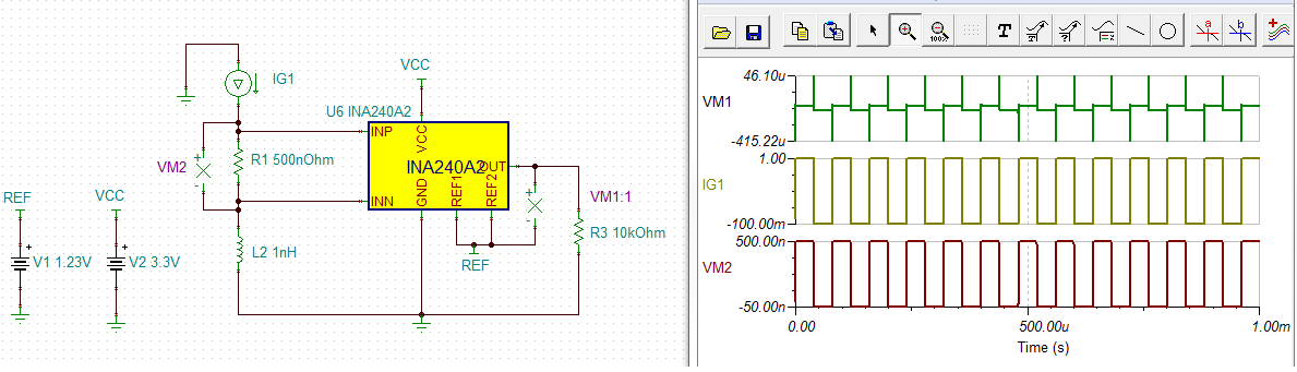

  • Accordingly TI-Tina transient analysis INA240A2 produces closely to that signal output on test bench. Accept for the negative 1/2 cycle pulses and the unexplained repeating +/- pulse surges, zoomed in makes sine wave result of pulse peaks. That has been an ongoing issue of INA240/282 in every inverter tested so far, the output oscillates in random AC wave pulse peaks no matter if capacitance is kept below 1nf. The Johanson X2Y EMI input capacitor Excel calculator is a bit behind and the CMMR versus Frequency graph Fig.12 when input 15mm steps produces a non monotonic  arc in the first graph (see attached).  Also the proper output impedance matching to SAR ADC is a must but that value is no where to be found in INA240 datasheet.
  • Let me add the 1st capture in this thread would incorrectly suggest an 15-20 amp phase current peaks, other test instruments more realistic report 2.6 - 3.0 amps @80vdc. Again scope current probe reports 50mv/A to match the typical phase current of other current measure instruments.
    Otherwise current above capture from scope thus measures 6-12 amps on 25mv/A probe setting showing in digital Min/Max/Peak readouts. That may just be X10 probe on INA output required X1 probe channel to reduce 50mv/A but all three instruments can't be wrong. That's why it seems the output gain doubles as if REF1/2 are not dividing output gain symmetrically so the full 50v/v ends up as very high positive/negative pulse peaks. Gain should divide 25v/v up and 25v/v down not produce 50v/v in both current directions.
    We thus subtract +1.225V (REF1/2) from the output amplitude to derive 25mv/A in software calculations. Then dividing the analog voltage from the INA240 relative to duty cycle in the ratio metric liner rise.

    I apologize for the delay in my response.  There a few reasons we think measurement setup can be an issue.  As you are using a low-side implementation we only expect the common mode voltage to fluctuate a few tens of mV.  As for the device gain, it corresponds to trimmed resistors calibrated at the factory.  Based off of our Gain bandwidth plot we expect the gain to be relatively constant up to a couple 100 kHz.  Beyond those frequencies we expect the gain to decrease and eventually attenuate the signal.  Those transients you are observing correspond to the rising falling edges of your PWM signal which can be decomposed of frequencies significantly higher than 12.5 kHz.  As such we do not expect the INA240 to be amplifying those.  However, we do think that there is ground coupling that is allowing those transient pulses to express themselves at your output.  Below, I illustrate the concept with a TINA model.  In this case I just have a parasitic inductor from the shunt to ground.  In reality, you could expect this inductor at the device ground as well as the output.  However, for this particular model it does not matter.  One thing to note, this TINA model is not the Cadence model.  It is a very simplified model of the part, best used for DC analysis.
    As you have your reservations about our proposed reason.  We definitely can test your circuit on the bench.  At the moment, I think your circuit looks like the following figure below.  Please correct me or fill me in on any details I am missing.  If you would rather not share this on the forum, let me know below.   I will send you a request through the forum to share details through email.

  • BTW: Your model has 500nohm shunt and ours has 500uohm shunt. Can you test transient results for 500uohm shunt to see any difference?

  • Below an older capture low side shunt (5mohm) reveals CMM peaks 375mv. Captured via 2 probes on shunt, 2 channel multiplication. Reveals typical shunt CMM symmetry is being distorted by the instrumentation amplifier output. The amplifier output (first post) is non-ratiometric, distorted and full of transient pulses relative to the saw steps captured across the shunt. The saw steps appear to drive differential amplifier transient response gain beyond datasheet CMMR specifications. Reducing shunt value by factor 10 to 5uohm lessons the effect in transient response to saw steps but it is still non the less present beyond figure 12 of datasheet.

    The point is 240A2 is amplifying low level PWM pulses from other than the shunt signal when it should be rejecting or ignoring relative to the quiet shunt signal posted above.
    There are no such transients present in the shunt wave form capture yet they are present on the output. Comparing INA282 10Khz nominal bandwidth output signal was not much different though pulse amplitudes were much lower being REF1/2 the RVRR (+/-25uv/v Min, +/-75uv/v Max).
    The high pulse amplitudes 1st post capture are due to 240A2 RVRR (2uv/v) thus amplifying 12.5kHz riding on the non-inverting amplifier input. There is low level 12.5Khz riding on +3v3 LDO supply to VS pin also feeding LM4041n +1.225v for REF1/2. The RVRR being very low at 50v/v and 20uv/v A1 @20v/v has better noise rejection. That is the troubling part being differential amplifier no matter the bandwidth will distort the output signal if PWM pulses enter VS or VREF pins. That fact should be know by the TI experts and not simply fly under the radar! Outside signals must be decoupled from VREF/VS pins and include datasheet examples how the LAB accomplished that before marketing these IC's in the way they have.
  • Another capture of INA282 REF1/2 ground, we do see some higher pulses yet more like valid event data. So we can't say ground noise is the entire issue since looks much better than INA240 output REV1/2 +1.225v or mid supply. And to think we thought captured signal below so troubling...
