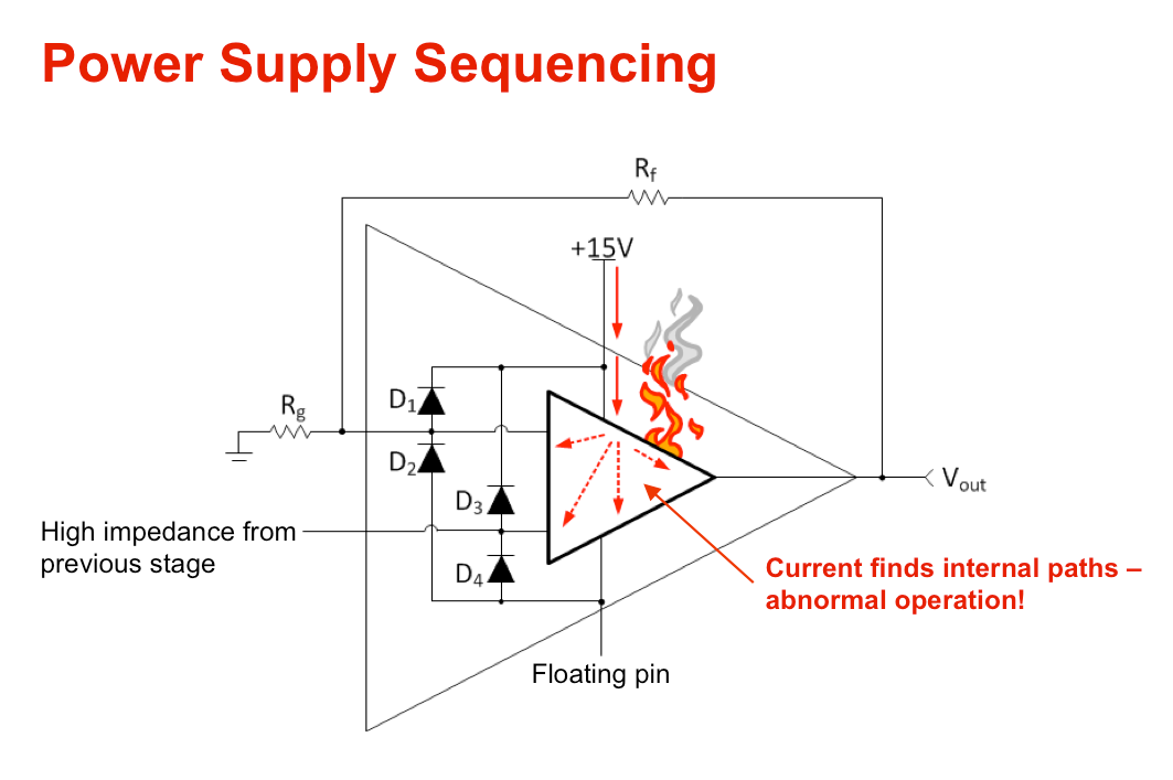

    It is very unlikely, if not impossible, that electronic Vos trim bits get improperly reset by sudden change in the input voltage – we have done plenty of characterization of OPA2192 and have never seen such problem.  However, from your description of the problem, it is most likely that the problem is caused by sequencing of the power supply.
    If the positive power supply is turned on first and the negative supply is turned on second (thus it is temporarily floating), for short period of time there is no proper current path from the positive rail to negative rail and thus the current finds parasitic path inside the op amp that may improperly load OPA2192 Vos bit or even cause permanent damage to IC– see diagram below.
    By connecting Transient Voltage Suppressors (TVS) across both power supplies as shown below, the TVS diodes are reverse-biased in normal operation BUT will become forward biased and provide a direct path for current from positive to negative rail in case the negative rail is floating. This prevents the device from going into an abnormal state which may cause improper loading of the voltage offset bits in case of OPA2192.
    Therefore, please recommend to your customer to add TVS protection diodes to their application circuit to eliminate the input offset issue.  This also protects the circuit from potential damage to the IC caused by transient over-voltages often occurring during turning-on of the supplies.
