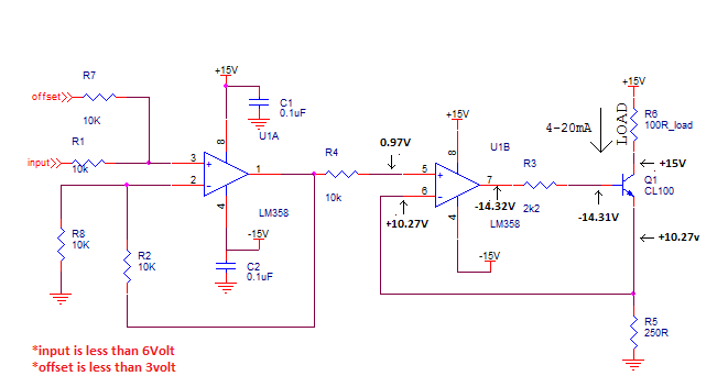

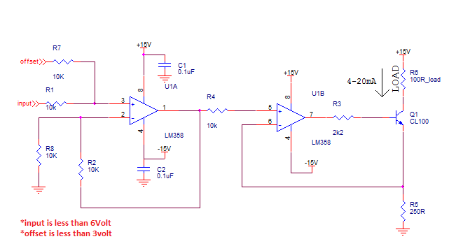

I use this circuit (see figure/attachment ) to generate 4-20mA for 100ohm load.
But I am suffering from frequent damage of LM358 on site as well as in my lab.
Thanks Ron Michallick for your kind reply.
second stage opamp gets damage.
In healthy condition, voltage at 5th pin and 6th pin are identical and voltage at 7th pin is 0.7volt more than voltage @6th pin.
but in damage condition, voltage @6th pin become +10.27V and @7th pin become -14.32V when voltage @5th pin is 0.97V.
but Transistor doesn't get damage in this condition.
Ron Michallick,
I use linear power supply for this circuit (Using LM7815 and 7915 regulator ICs). so I don't think -15V supply goes positive or it doesn't power up correctly.
Does absence of LOAD (100ohm at collector) may be the reason of failure ?
A couple of questions:
Is the load resistive as shown? No inductive component?
As Ron mentioned, a diode from the base of Q1 to ground is recommended.
Is the circuit oscillating? I'd put a small capacitor across R2 and from pins 6-7.
Adding a resistor (100) between the emitter and pin 6 limits the current into the device.
Lastly, did you see this: https://e2e.ti.com/support/amplifiers/etc_amplifiers__other_linear/f/18/p/431250/1546348
Mike T.
Hello Mike,
Thanks for your reply.
The load is inductive in nature (this circuit is used to drive control valve ).
Can you describe which kind of diode I should use like, general purpose diode / zener or TVS diode or any other ? and according to Ron, diode should be connected from base of transistor to emitter and you said base to gnd.
The circuit is not oscillating.

Mike,
sorry for wrong feedback, this output (4-20mA) is feed to smart positioner which is not inductive in nature.
smart positioner contains microcontroller circuitary which reads 4-20mA through some signal conditioning circuit and generates analog output accordingly to drive control valve. smart positioner has its own control valve drive circuit.
so basically, this 4-20mA signal is not going through any kind of inductive load.
