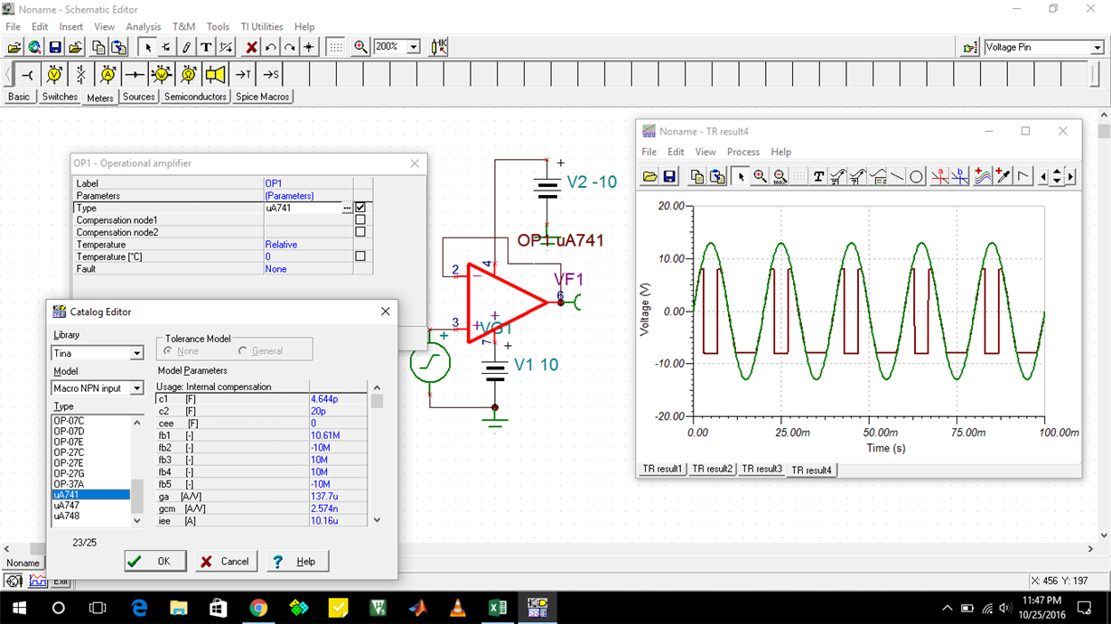

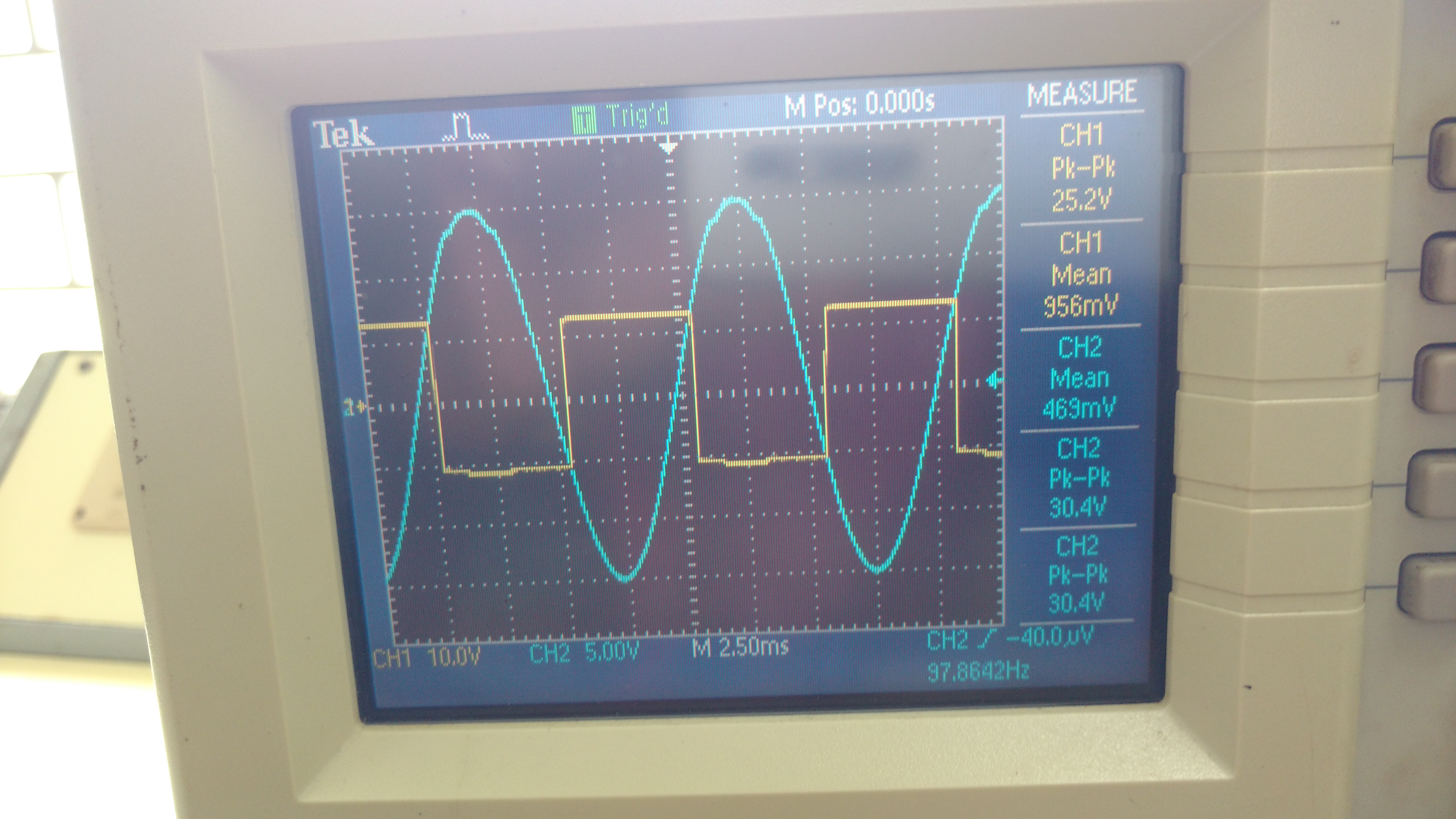

While working with LM741, I happen to apply input more than the supply voltage to the Op amp. And for all the circuits, like for a simple buffer, Schmitt Trigger circuit I noticed the same output. The circuit and the simulation results are attached. What is the reason for this behavior, and why does the Op amp behave so for only one half cycle?
