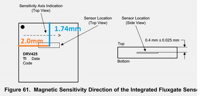

Hi there. I have DRV425 chips reading magnetic fields of magnets about 1/16 the size of the chip. There is a small arrow on the top of the chip indicating what I believe to be the most sensitive region and also the direction of sensitivity. I have to make a 3D model with the magnet placed directly over the chip, however, I do not have the exact dimensions of the chip nor the exact measurements of where the sensitive regions are on the chip. Unfortunately, the data sheet doesn't have this information either.
If I could get help with finding the exact dimensions and regions of sensitivity on the chip, that would be wonderful!
