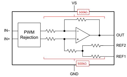

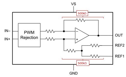

    Q1.
    > The 125K Ohm resistance highlighted in the diagram really should be 500K.
    Regarding 500 kΩ, which of figure a or b is correct?
    *Figure a
    *Figure b
    Q2.
    How much is the internal resistance of INA240-Q1 respectively?
    -Harukawa
  • Hello Harukawa,
    Q1 – Figure “a” is correct.
    Q2 – a)=500K, 200K, 100K and 50K for A1/2/3/4 respectively. b)=475K; c)=50K
    Regard, Guang
