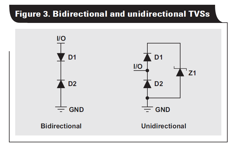

    The damaged input impedance (Zin) indicates a root cause of ESD or EOS (electrical overstress). While this does not seem like it should be the case since you have an ESD protection IC (TPD4S012), I still think ESD is possible after looking through datasheet. One critical aspect to note about INA199 is that it’s absolute minimum input common mode voltage (VCM) is -0.3V (see Table 7.1). If VCM goes below -0.3V then the internal ESD diode to ground will forward bias, conduct excessive current, and permanently damage. This results in a low-impedance path to ground since ESD cell will become small resistance.
    While the TPD4S012 (and the ESD cells of INA199) protect against transients of + or – thousands of volts (see Table 7.2 of INA199 datasheet), the protection is not the same in both directions. If you look at the TPD4S012, you will see that inside are unidirectional TVS diodes for ID, D+, and D- pins.
    You will also see that the breakdown voltage (VBR) for the Zener diodes are 6 to 9V and the forward voltage (VF) for the diodes are 0.6V to 0.95V. So if there is a positive voltage transient at INA199 inputs, the Zener diode will go into reverse breakdown to dump energy and the diode on same line as Zener will forward bias. The other diode to ground will remain in off.
    If there is a negative voltage transient, then ID pin’s diode to ground will forward bias and dump the energy, but it will only do so after negative voltage has become greater than diode VF (0.6V to 0.95V). Thus, there will be a time INA199 ESD diodes being stressed and this will be when -0.3V > VCM > -0.95V. If you look at Figures 8 in TPD4S012 datasheet: “IEC Clamping Waveform, -8kV Contact, D+, 25 ns/div”, you see that even after diode has clamped the large ESD signal there is 225ns of the voltage hovering just below 0V.
    I am not saying that 225 ns is enough time to damage the ESD cell, but if this event occurs repeatedly it will wear down INA199 ESD cell causing it to become internal short. Just because the TPD4S012 will survive these ESD events does not mean the INA199 will, especially if the absolute minimum VCM is -0.3V. Protecting devices from EOS events of less than -0.3V can be tricky. You can read more about way to protect against this and also about limiting current into input pins at our following FAQ pages:
