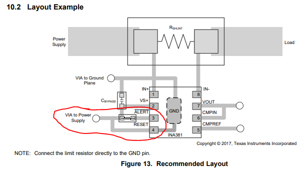

Hi
I have question for INA381.

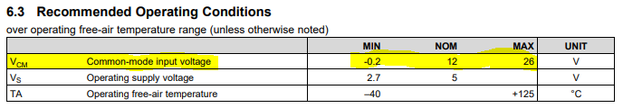

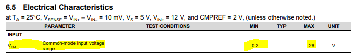

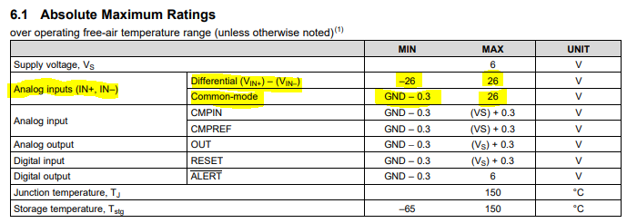

1.
The recommended differential input range is not specified in datasheet.
http://www.tij.co.jp/jp/lit/ds/symlink/ina381.pdf
Does it have this spec?

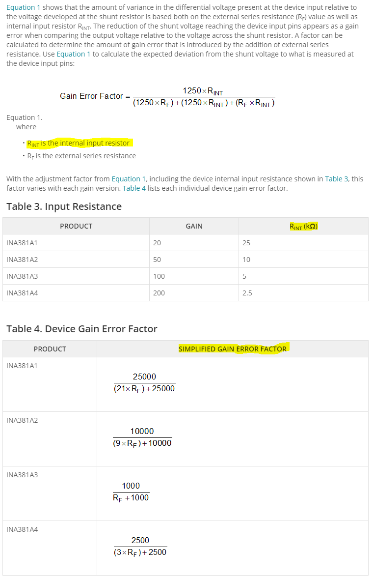

I will make the device generate alert at 1A current using 50mohm resistor.
2.
Does the shutting down Vs also reset device instead of toggling RESET pin?
For example, is connecting RESET to VS acceptable?

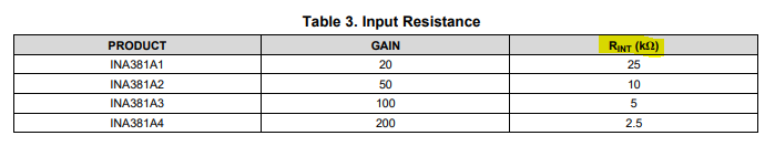

3.
Is Table 3 in datasheet not applicable to INA381?
