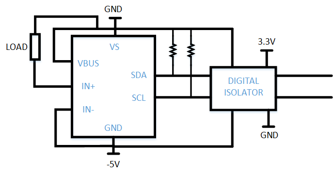

INA260: Can I measure the negative voltage use the INA260?
Part Number: INA260
I want to measure votage of -5V 2A,I see the datasheet says the "common mode" votage is -0.3~40V. So,can I connect -5V to the VIN- pin to measure current ? and connect -5V to the GND measure the -5V votage(but AGND and DGND both is GND )? or convert the -5V to 5V then measure the 5V votage? see figure.  Is that ture?  or  can you recommend a chip that can be used?  Thanks
