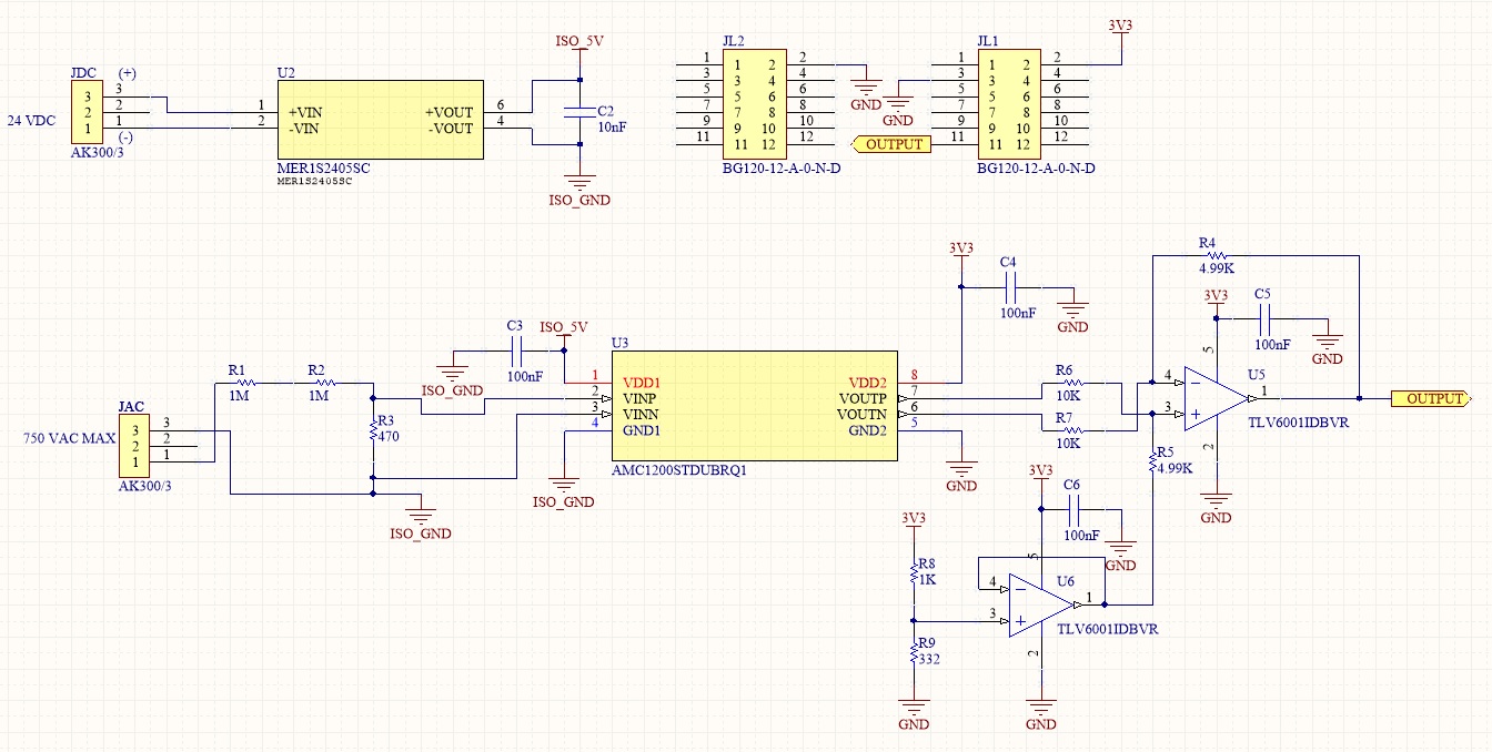

AMC1200-Q1: Measuring 0 V to 600 VRMS, measuring frequency 0 Hz - 70 Hz Isolation Stage.
Part Number: AMC1200-Q1
Other Parts Discussed in Thread: AMC1200, TLV6001, TLV170
Hi, This is Mike
After all, Thanks for all your support.
I've been searching for a while about some amps and things like that.
Here it is the circuit I designed thanks to all the comments on TI and the experience the app notes of TI has given to me.
So, Do you see something here?  I mean, I think this circuit is ok but what do you think?
I think I'll have running this thing the Friday!
Mike
