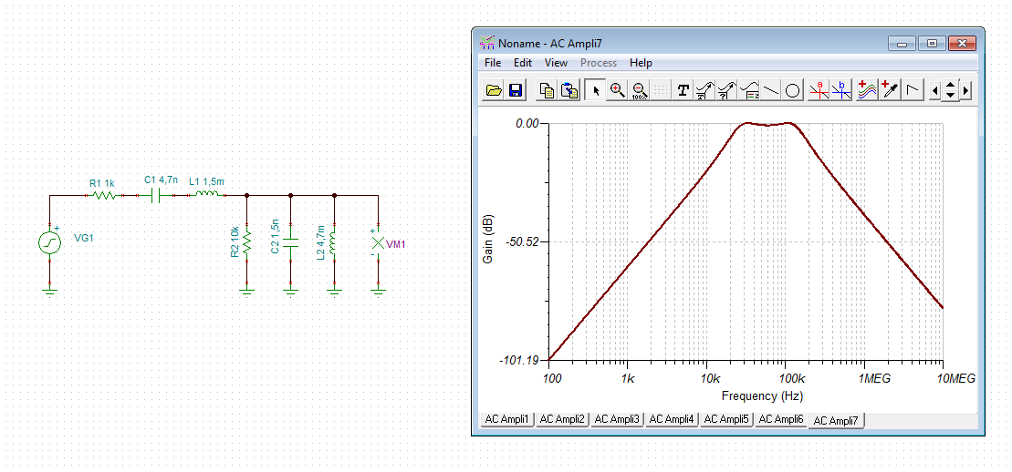

I cannot see that the formulas are incorrect. If you set f1 = 35kHz and f2 = 95kHz for the "Cenelec A" band you get the band pass components values shown in table 4 of datasheet. The frequency response is quite useful:

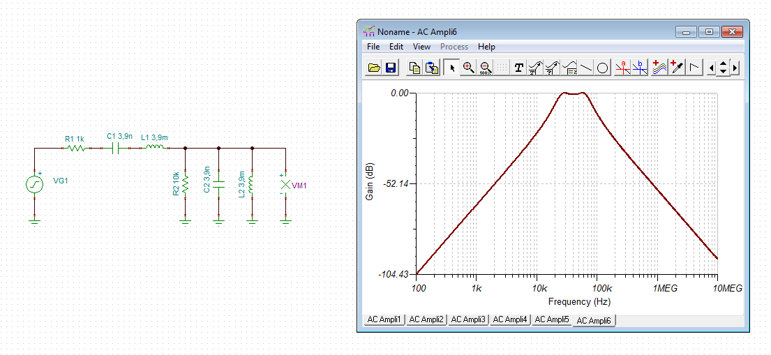

If you set f1 = f2 = 40kHz you will get the following curve:
Kai

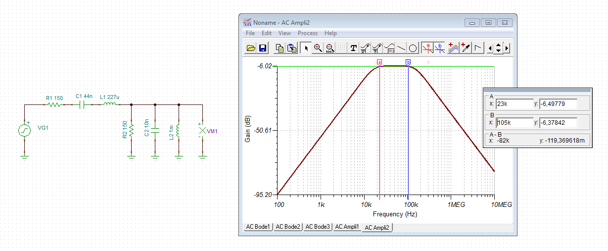

Hi Victorija,
the filtering response of the bandpass filter of the application note is a bit sharper. The drop in frequency response at 23kHz and 105kHz is -3dB:
The drop in frequency response of the "calculated" bandpass filter at 23kHz and 105kHz is only about -0.5dB:
Yes, you are right, both filter components appear to be gained from different formulas. But, apart from the sharpness, the frequency responses are nearly identical.
Kai
