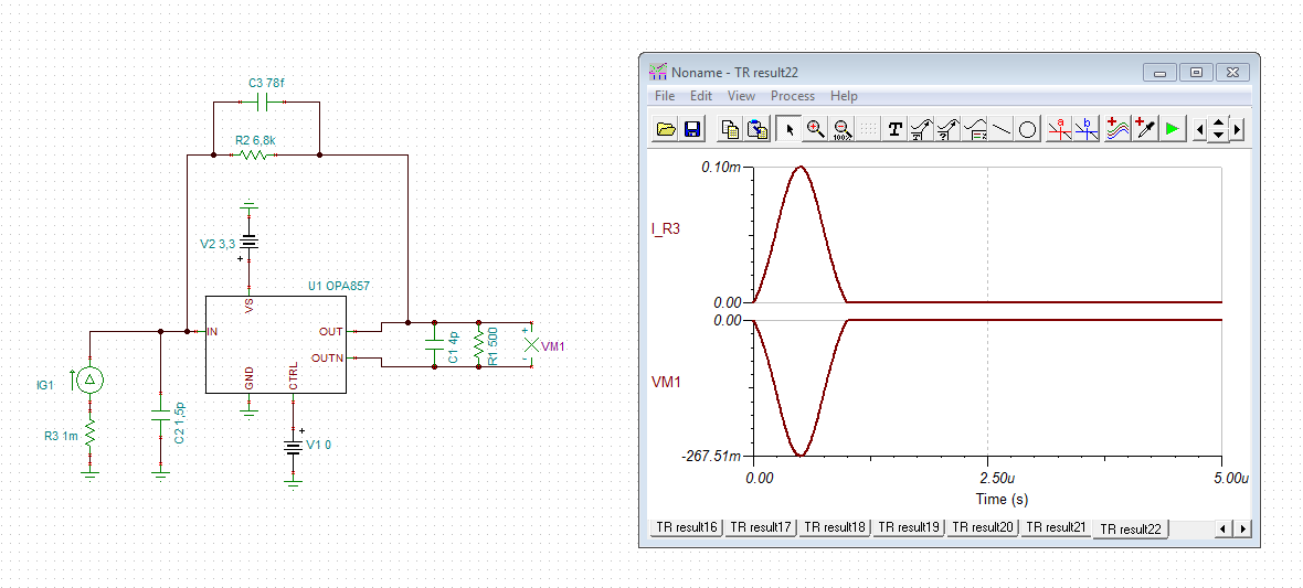

hi,
i have generated a Gaussian pulse with pulse width of 10ns in matlab and generated a .WAV file.
after generating the .WAV file and while giving the .WAV file as input to the schematic design of OPA857 the input gaussian wave generated   time axis is changing into milliseconds during the schematic simulations
please help me how to solve this problem.

  • Hi Harini,
    and this would be the pulse response of your circuit (the Gaussian pulse normalized to 100µA):
    harini1.TSC
    Kai

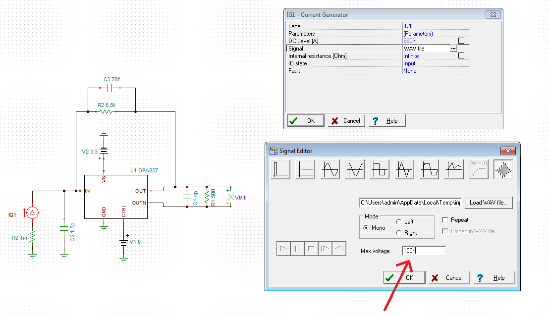

  • hi,
    thank you for your suggestion
    i tried using pulse shaper for generating Gaussian pulse, i have generated a Gaussian pulse for 100nV amplitude using voltage  source.
    but when i am using a current source input there is no output response
    please help me to solve this problem as my input to the OPA857 is through a current source

  • Hi Harini,
    I only "see" the current in the simulation when it produces a voltage drop across the shunt resistor. So, the current is there. Take my simulation file and play with it.
    The amplitude of Gaussian pulse can be changed in this window:
    To change the width of Gaussian pulse I think you must create a new WAV_file.
