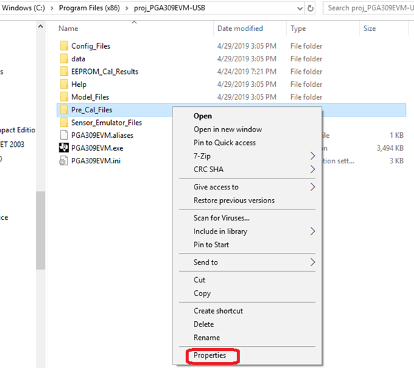

    I do have another question (sorry), I can not seem to be able to load a different profile then the defaulted one. I want to set a new configuration (pre-cal) but it never seems to change. It mentioned administrator rights, which I have.

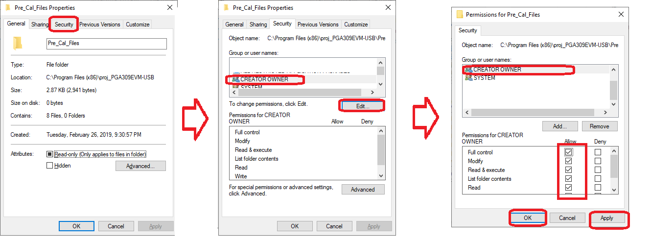

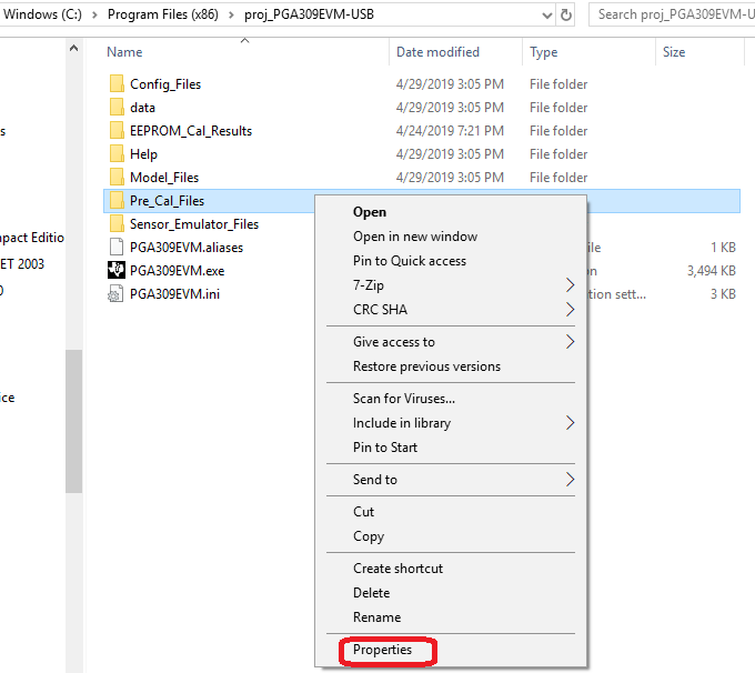

    Thank you for the update.  I recently refreshed to a new PC with Windows 10, and although I have administrator privileges, and installed the software properly, I ran into an issue when trying to modify the Pre-Cal file, and sensor files used by the PGA309 GUI.  In order to resolve the issue, I had to manually change the permissions on the folders.  The following directories may need to add full control to the user:
    :\Program Files (x86)\proj_PGA309EVM-USB\Model_Files
    :\Program Files (x86)\proj_PGA309EVM-USB\Pre_Cal_Files
    :\Program Files (x86)\proj_PGA309EVM-USB\Sensor_Emulator_Files.
    Please see example below, let me know if you still have issue writing/saving the files.

    In order to allow the user full control, please perform the following steps:
    1) Using Windows explorer, Browse to the folder,
    Root directoy:\Program Files (x86)\proj_PGA309EVM-USB\Pre_Cal_Files
    - Right click on the folder on explorer, select properties
    2) Grant full-control to the user as shown below:
    - Select Security, select your user name on the PC, and check mark "allow".
    - Click on "Apply" and click on "OK"
