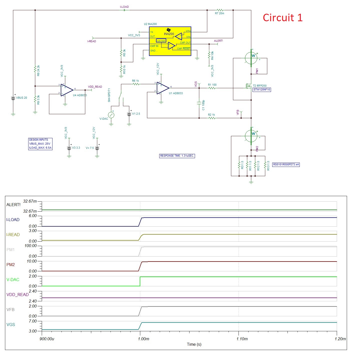

I am Designing an Eload. In Circuit 1, My feedback voltage is less. as my DAC output (V-DAC) varies from 0-2.5V Circuit works as per my expectations (No amplifier in feedback path).
But in Circuit 2, Since my DAC voltage goes to 5V. In order to reduce the power dissipation across R3, I used INA193 to convert that current to voltage and feed it to the U1. But when I run a transient response, I am getting oscillations. Can someone tell me how to compensate these oscillations with some feedback mechanism? (R12 &  C1) . Are there any calculations or formulas available to do this?
Please find my both circuits as well as simulations file.

    The INA193 is part of your feedback and this is placing the U1 device in an unstable condition.  There is set equation I have for you but please look at our precision labs training series for stability (See section 10).  This will help give insight on what is causing the issue and how you can approach the problem. I would in particular look at video number 3 in this section.  Please let me know if you need further assistance.
  • hello Javier,
    Thanks for your response. When I replaced C1 from 100pF to 100nF. It started working. I will look into the Video Series.

  • Vishal,
    Good to hear that resolved your issue.  The videos will help with understanding it and will also help with making how much margin you have.
