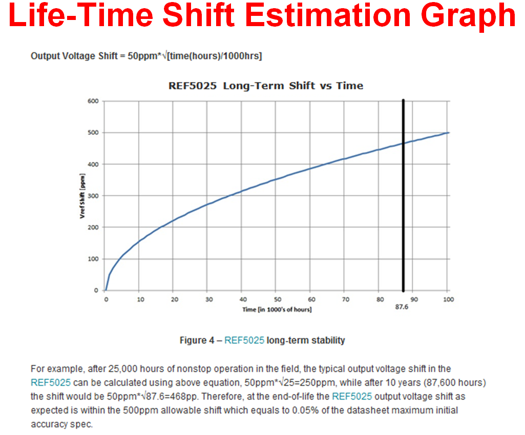

  • All life tests, including OPA548, are conducted for an equivalent of 10 years (87,600 hours) of constant operation at 25 deg C so any specification above 10 years is not guaranteed. The maximum life-time shift of any parameter expressed as an absolute number, like Ilim, may be up to +/-10% of its maximum specified initial error but most shifts are much lower than that.  Since max/min Ilim is not specified in the datasheet, its maximum Ilim life-time error may be up to 10% greater than the actual error initially measured. The shift may also be approximated by the square-root function of time - see below.
    Having said that, since at 25 deg C most IC’s can last far longer than 10 years, for as long as the part continues to work the long-term shift should continue to follow square-root function equation, which means after 25 year the max shift could be no more than: +/-10%*sq-rt(25/10) = +/-15.8% of actual error initially measured.
    Of course, all of the above considerations do NOT include shift caused by the long-term change of the value of an external resistor, Rcl.
