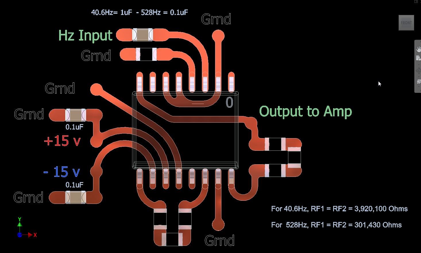

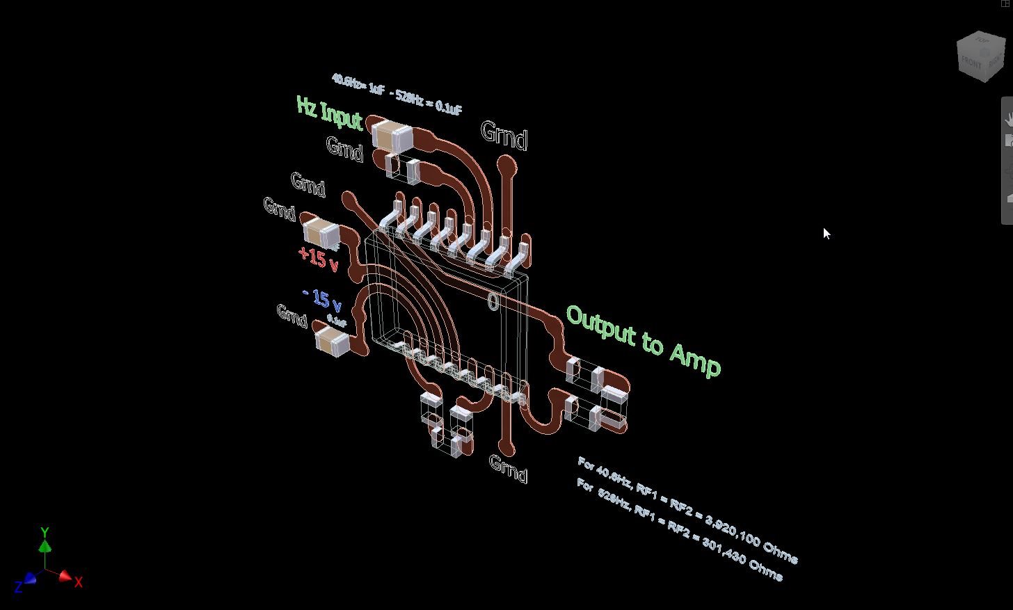

The Bandpass Filter UAF42 diagram is based upon the plastic 14 Pin Package and there does not appear to be one for the 16 Pin SOIC surface mount package.
I have attached an amended version of the filter with what I believe are the correct Pins for the 16 Pin package. Can you, please confirm or otherwise?
My input frequency voltage is only circa 1.5v but I am proposing to run the UAF42 from a 15volt parallel rail supply. Will this present a problem?
Should I have a decoupling capacitor between V+ Pin 11 and Ground , and if so will a 1uF capacitor be adequate?
On some of the UAF42 filter diagrams VIN2 is connected to ground Pin 12 via a RQ which varies in value. The two square wave frequencies I am converting into sine wave are circa 40Hz and circa 530Hz. Should I add a decoupling resistor between Pin 4 and Ground, and if so, what size(s) should I use, please?
Thank you so very much.
