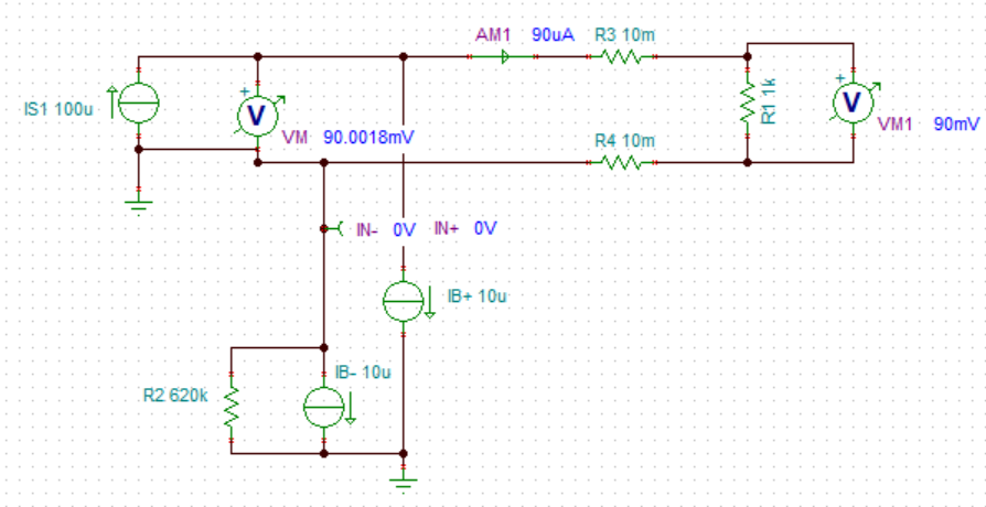

  • Hey Glenn,
    Yes. The INA3221 can measure small voltage drops across a shunt resistor, which is usually pretty small (<100-Ω). In your case, you are injecting a known current and determining the DUT resistance.
    Unfortunately there could be some problems with the input bias currents (IB) of the INA3221 depending on what the injection current is an what the input common-mode voltage floats to during the measurement. The IB for INA3221 at 12V VCM is 10uA (see datasheet). I would suggest running this in a simple SPICE simulation for all possible cases as shown below.
    If the relatively low input impedance of INA3221 (a current sense amplifier) introduces too much error, then consider using an instrumentation amplifier (e.g., INA333), which will most assuredly have a very high input impedance; however, it cannot operate on a voltage rail that exceeds its own supply voltage similarly to what the INA3221 and other current sense amplifier can do.
    Hope this helps.
    Peter

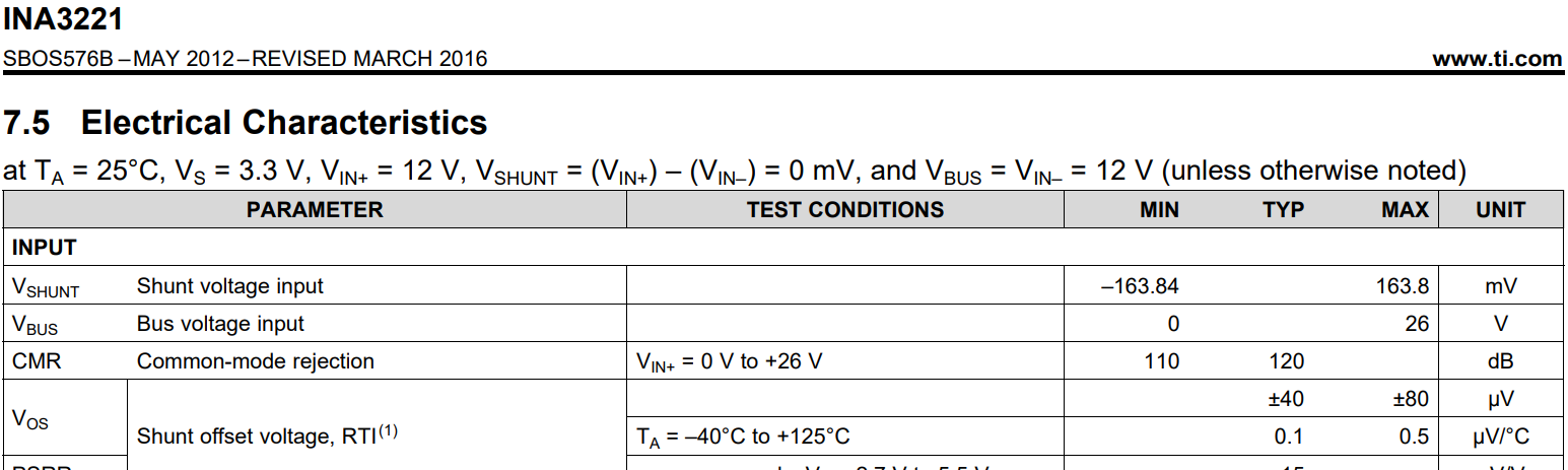

  • Hey Glenn,
    This latest design will not work. The INA3221 can only sense a full-scale range (FSR) of ±163.8 mV. This is shown in datasheet specifications table.
    Thus, differentially sensing 2.489V at the input will saturate the device and report to the MCU a shunt voltage reading of +163.8mV. Additionally, the bus voltage measurement (done with the IN- pin) will report 0V since it is connected to ground.
    If the point is to determine the resistance of R2 and I1 is a constant source, then I would insert back the shunt resistor to measure the current (11mA) as the part is intended. I would make sure the IN- pin is closest to R2 so that you can also measure the 2.489V drop, which will be reported as the "bus voltage" in the INA3221. Excluding errors from R1 and R3, you could calculate R2 a VBUS/I = 2.489V/11.12mA = 223.8Ω.
    There are definitely other ways to solve this problem. You could move the shunt resistor to the low-side so input bias current drops significantly and any offset in IB currents does not create an offset across R1 and R3. The INA226 is much more accurate and has a separate VBUS pin which you could connect to the high-side of R2 to sense 2.489V as the bus voltage.

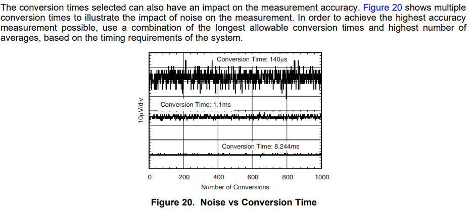

  • Hey Glenn,
    Determining the overall system resolution may require some testing, but the best case resolution will be the LSB of the shunt ADC which is 2.5µV. However, the current and resistor thermal noise could end up being larger than 2.5µV. Let' say that your shunt voltage noise is 4µV pk-pk. This means a 3µV change in the shunt voltage (3uV/R current change), may not be easily resolved by the device, at least instantaneously.
    Fortunately, you can use the customize the acquisition (or conversion) time of the signal and add differing levels of averaging to further clean up the signal. Se section 7.4.1 of datasheet for more information. Overall increasing the conversion time and averaging will reduce noise in the measurements, but slow down BW.
    I also highly recommend watching our TI Precision Labs training videos, specifically the ones about noise. This will show how to convert spectral noise density into peak-to-peak voltage values so you can understand the noise floor of your system. Consider researching the noise of the current source in you system.
