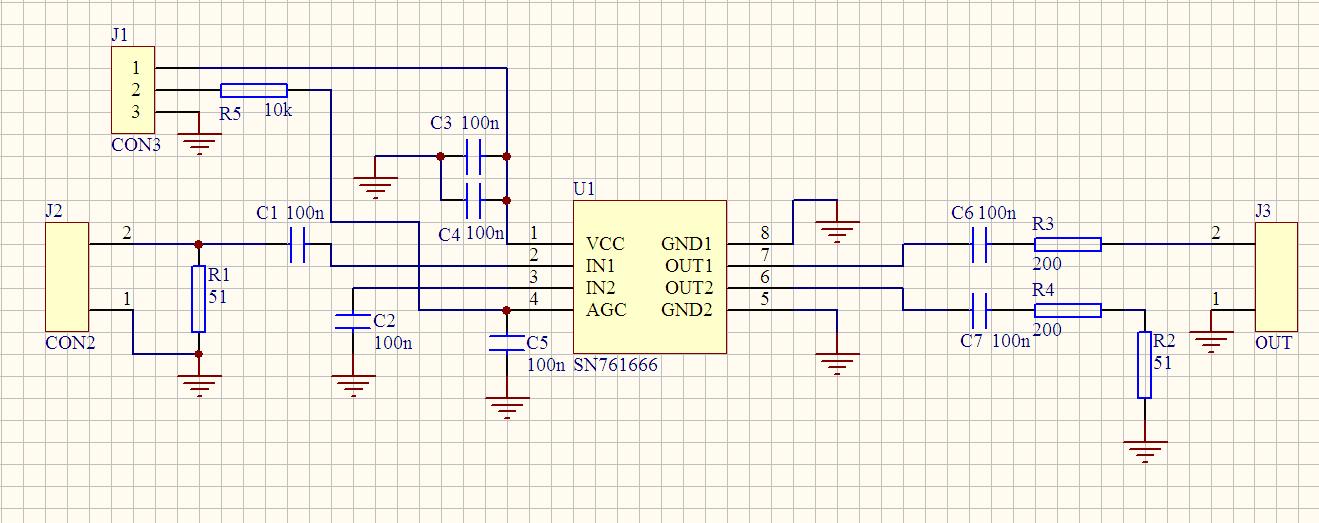

I made an test board according to SN761666 data sheet. But I couldn't get it work. My signal is within 10M~30M range. MY schematics is as following. Can you point me to the right person or the right place to ask for checking this schematics. Thanks a lot.
Yan
From Hideo Nishi:
I regret to say there (is no longer) support (for) SN761666. Sorry for your inconvenience.
SN761766 is a simple GCA. Please check following items.
- Voltage of AGC-pin : AGC-pin has internal pull-down resister 100k ohm. This resister and R5 divide control voltage.
- Isolation between input signal and output signal : It happens undesired oscillation due to in/out interference.
- Connect GND1 and GCA2 lines at root of GND respectively, not to have common impedance.
Hideo Nishi
