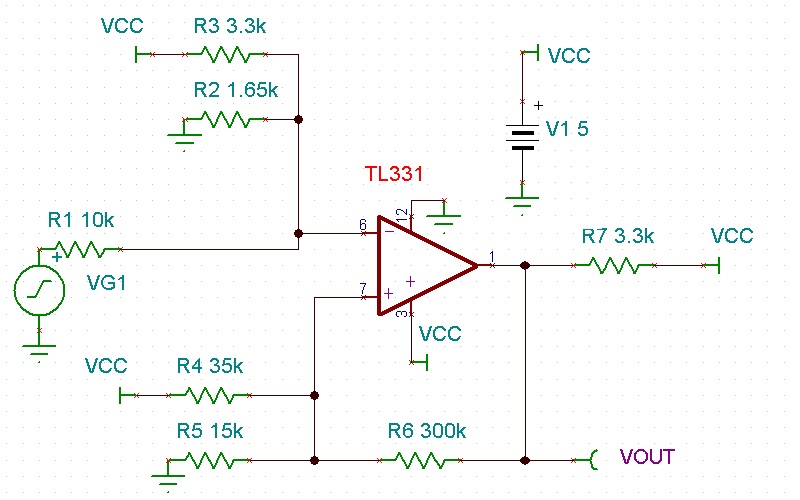

 I want to use/cut the output signal characterized as+-10V, 31 kHz, and dutyfactor  0.5 +-5-10% from the seconary side/ secondary coil of a Flyback topologie as a  5V controlsignal.The pulsewidth of the 5V control signal variable pulsewidth will be utilized for regulating/controling a servosystem consisting of CMOS. Today I use Zenerdiods( the last 5,1V)/ to cut the split of the output signal above down to around 5-6 V,but thereI get a no desireble minus voltage of 0.6V from the zener.
I want to use  an op. amp instead and think the TL331Q would do...Please give me a suggested connection scheme with suitable resistor value, and how I handle the earth and IN' and IN- . It's  fed from a +5V supply LP2985.

  • Christer,
    I attached a circuit that should work well provided that the TL331 is fast enough.
    Resistors R1-R3 convert +/-10V to 1.5V +/-1V. The attenuation supports up to +/-15V input.
    There is a 1.5V bias on the non-inverting input with some hysteresis.

  • Christer,
    Chose the the TL331 that covers your temperature range needs.
    The circuit changes the amplitude of your input range (gain/attenuation) and changes the center voltage of range (offset). The reason is to make sure the common mode range of the TL331 is met. I chose 1.5V because it is the center of 0V and VCC-2V.
    On the TL331, the common mode input voltage is actually the input pin with the lowest voltage (most negative, least positive). Only one input needs to be in the common mode range, the other input can go as high as 30V. If any input goes negative then the current must be limited and the output may be invalid.
    I attached a spreadsheet that I use to find a trio of resistors to change one input range +/-X to a new range. Change only the yellow cells.
