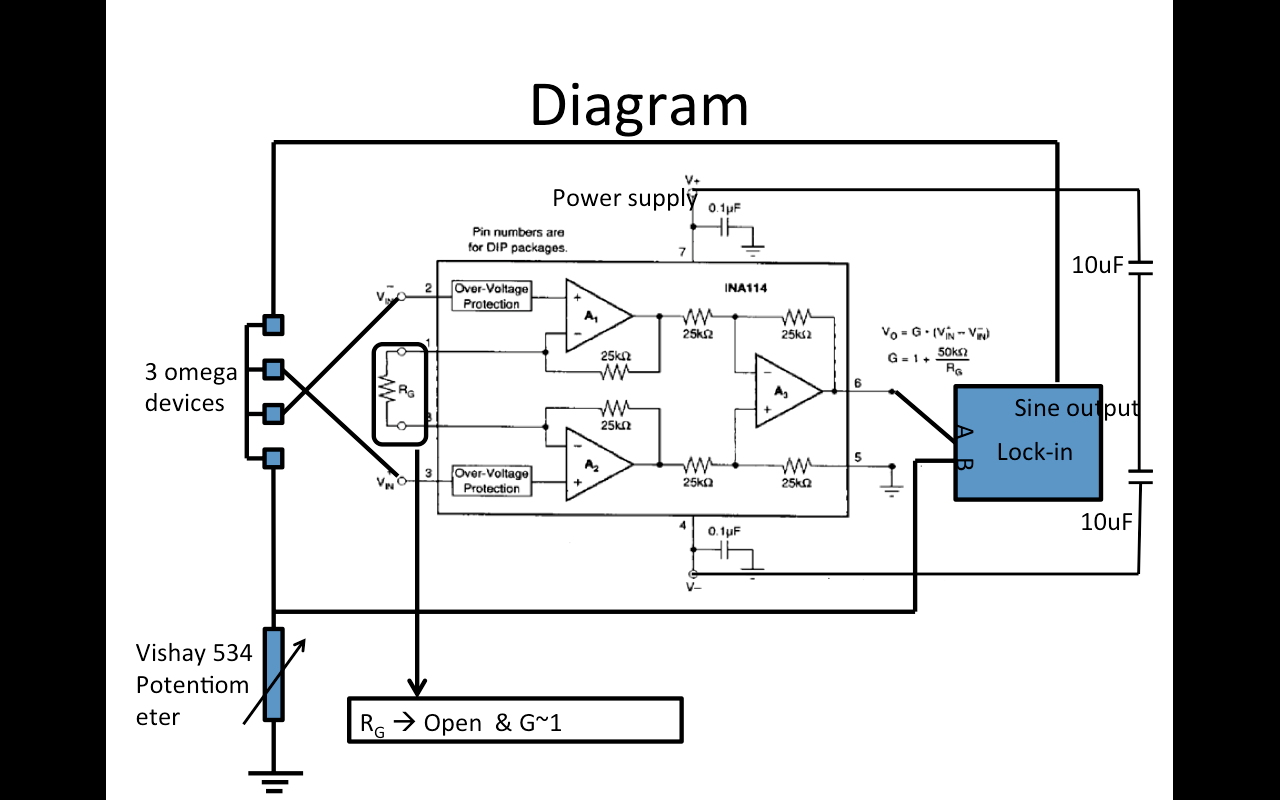

I have been using INA111 for the following circuit (3-omega measurement set-up) and it works perfectly fine up to 100KHz. However I need to push the fundamental frequency up to a few MHz and I couldn't find any good instrumentation amplifier for this matter! Does anyone have any suggestion of what to use? Please note that the swing is also very important and that's probably one reason that I cannot use INA111 above 200-300KHz.
