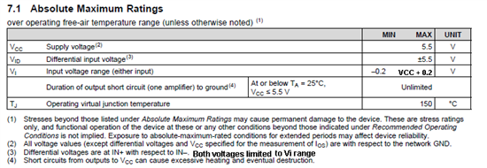

We found that the absolute maximum rating of input voltage range is mentioned on page 3 of LMV324 data sheet as below.
Is it possible to apply 5.5V to input pins of IN+ and IN- if LMV324 is lost the power supply?
We are concerned since there are the diodes between input pins and the power supply pin.
