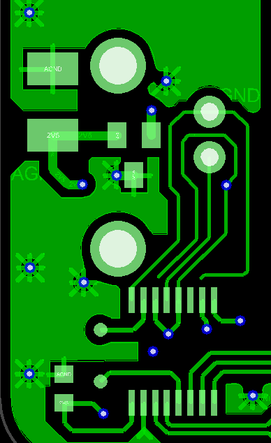

We are design a pH sensor using a LMP91200. The problem we are facing is that the pH measurement is not matching the mV equivalent when a pH electrode is used. For example, at 177mV input, we measure 3.98pH when a low impedance mV source is used. But when we use a high impedance electrode, the pH measurement is off by more than 2 pHs. We follow the recommendations on the datasheet for the layout (remove solder mask from the input traces) and guard rings, and we are using a BNC connector for the input.
What could affect the input impedance of the LMP91200? Is there something that we could be missing?

    The liquid under test is in a glass counter. It is not at ground potential.  Here is a copy of our pH input PCB layout:
    Please let us know if it is correct. We followed the specs on the datasheet of the LMP91200 to removed the solder mask around the input lines of the LMP91200 and added the guard ring on both the top and bottom layers of the board.

  • Hi Miguel,
    the layout suggested in the DS is different, the connector showed in the Datasheet (below) is a triax. The main central connector of the Triax is INP, the second central connector is the guard, the shield connector is the VCM.
    Your layout even if different (based on 2 pin connector) is good.
    I have some doubts on the VCMHI. Where have you connected that pin ? it is a very sensitive pin (high impedance) so you should leave it floating, any load connected to that pin generates a drop on VCM.

  • Hi Domenico,
    We connected the VCMHI pin to a test point. The voltage in the VCM pin is 1.25V and Vref is 2.5V.
    We did more tests to try to understand our problem. We added a voltage buffer between BNC connector input and the INP input of the LMP91200 and that solves our problem. The error is now +/-0.02pH after calibrating our devices using a mV source and measuring pH buffer solutions for 4,7 and 10pH using an electrode. Without adding the voltage buffer, the error is +/-1pH after calibrating our devices using a mV source and measuring pH buffer solutions for 4,7 and 10pH using an electrode.
    The LMP91200 should work without a voltage buffer connected at the INP input. Could you please tell us if adding the voltage buffer is necessary or we should look for another solution?
