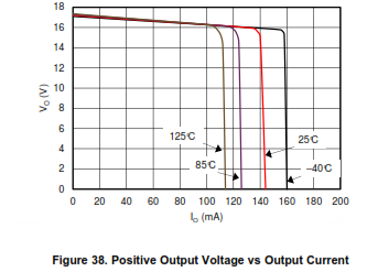

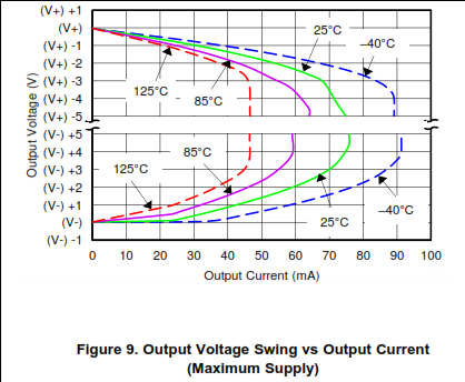

I'm looking for a dual channel Op Amp with 50mA sink and source capability at 70C ambient temperature. Small package size is preferred. The power supply is +3.3V and -3.3V. Output should be rail-to-rail and it almost outputs a DC signal(low bandwidth signal).
I'm comparing Short-Circuit Current spec. I think OPA2172 in 3X3 QFN would fit. Could you help confirm it or recommend a better solution?
