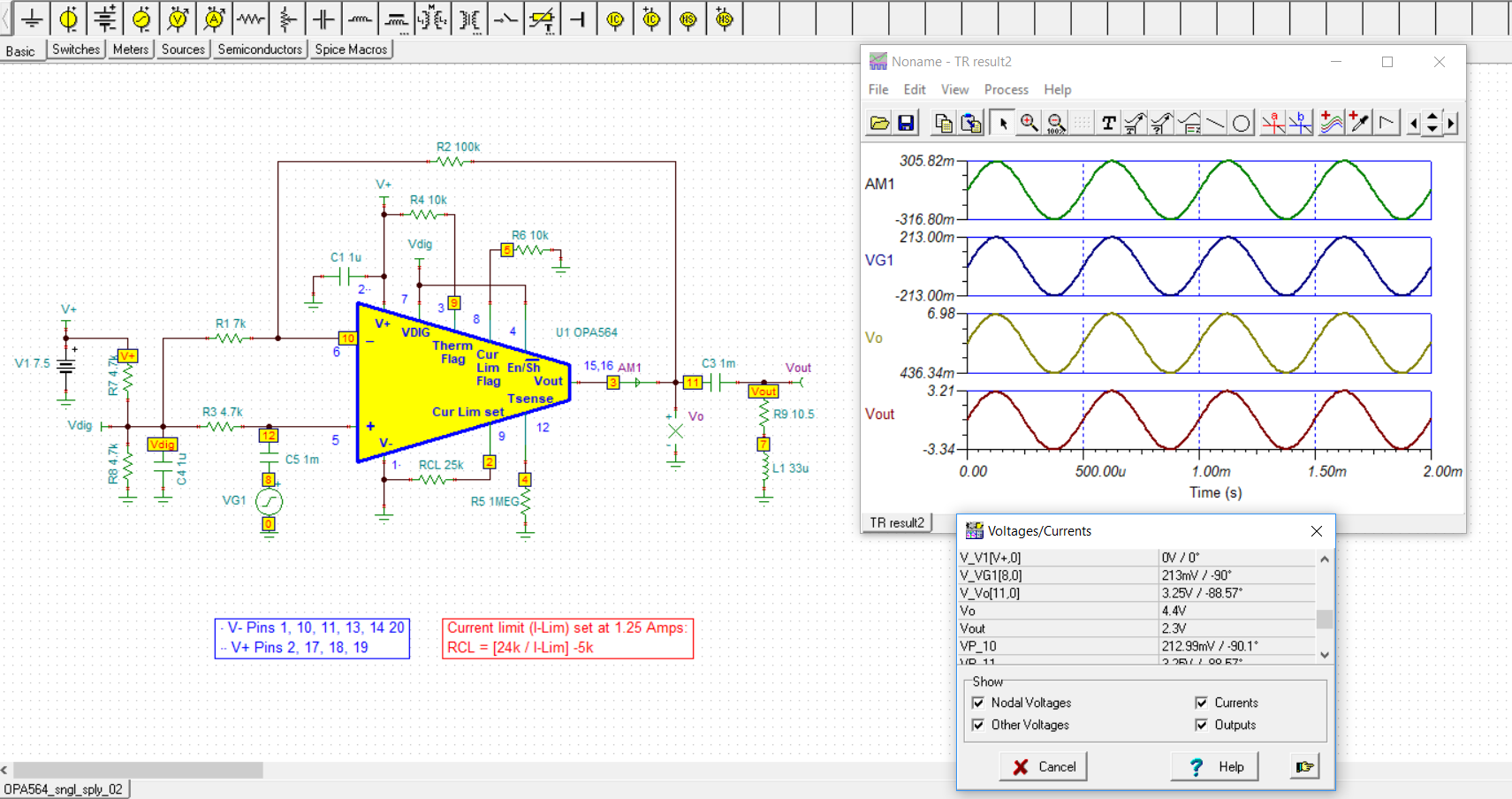

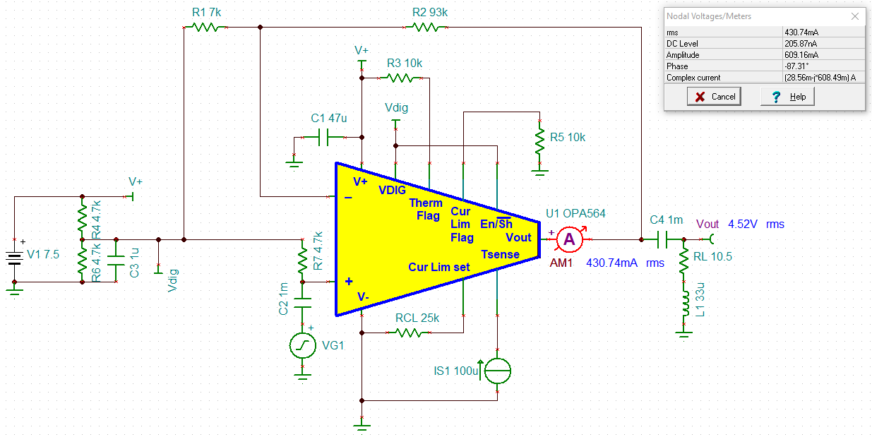

     I set up my circuit like this for now (Basically what you linked minus the buffer) . Feedback pot. is now also 100k :
    However, actual output voltage is only 3 Vrms. Is this due to the lack of the Vdig/Vmid buffer?

    Your TINA circuit schematic indicates that V1, which is the V+ supply for the OPA564 is set to +7.5 V, and the output current is approaching one-half ampere. The OPA564 output swing to the supply rails with that load current will be about 0.5 V, or the output can swing as a maximum will be limited to about +0.5 V to +7 V. Therefore, the maximum peak-to-peak output swing is about 6.5 Vpp.
    If we calculate the RMS voltage for a 6.5 Vpp sine wave, that is 0.3535 (Vpp) or 2.3 VRMS. Thus, unless the V+ supply voltage is increased to something greater than +7.5 V, the OPA564 cannot deliver any higher output voltage than 2.3 VRMS. It might swing a bit more if the input is increased beyond 213 mVpk (the maximum peak input based on a closed-loop gain of 15.3 V/V), but the output will be clipped because it has hit its maximum swing capabilities.
    I am not sure how your were able to attain the 4.52 VRMS, unless that is the RMS value of a severely clipped sine wave. I don't know what peak input voltage VG1 is set to, but knowing what that is would help in an analysis. When I simulate the circuit as shown below I find the output swing is limited to the 2.3 VRMS as calculated.
    I have attached my TINA circuit for your use.
    OPA564_sngl_sply_02.TSC
    Regards, Thomas
    Precision Amplifiers Applications Engineering
  • Hi Thomas,
    I understand my error now. I made the assumption that a voltmeter reads average peak to peak voltage and not average voltage (It is a cheap voltmeter so I think it is an average and not true RMS). Likewise, in my TINA circuit I assumed peak to peak on the input function generator voltage and so entered .45 V, hence the clipped 4.52 V output.
    My real circuit roughly goes to a reasonable 2.1 Vrms now without distortion. Everything makes more sense now. Thanks for the help and sorry for the confusion.
