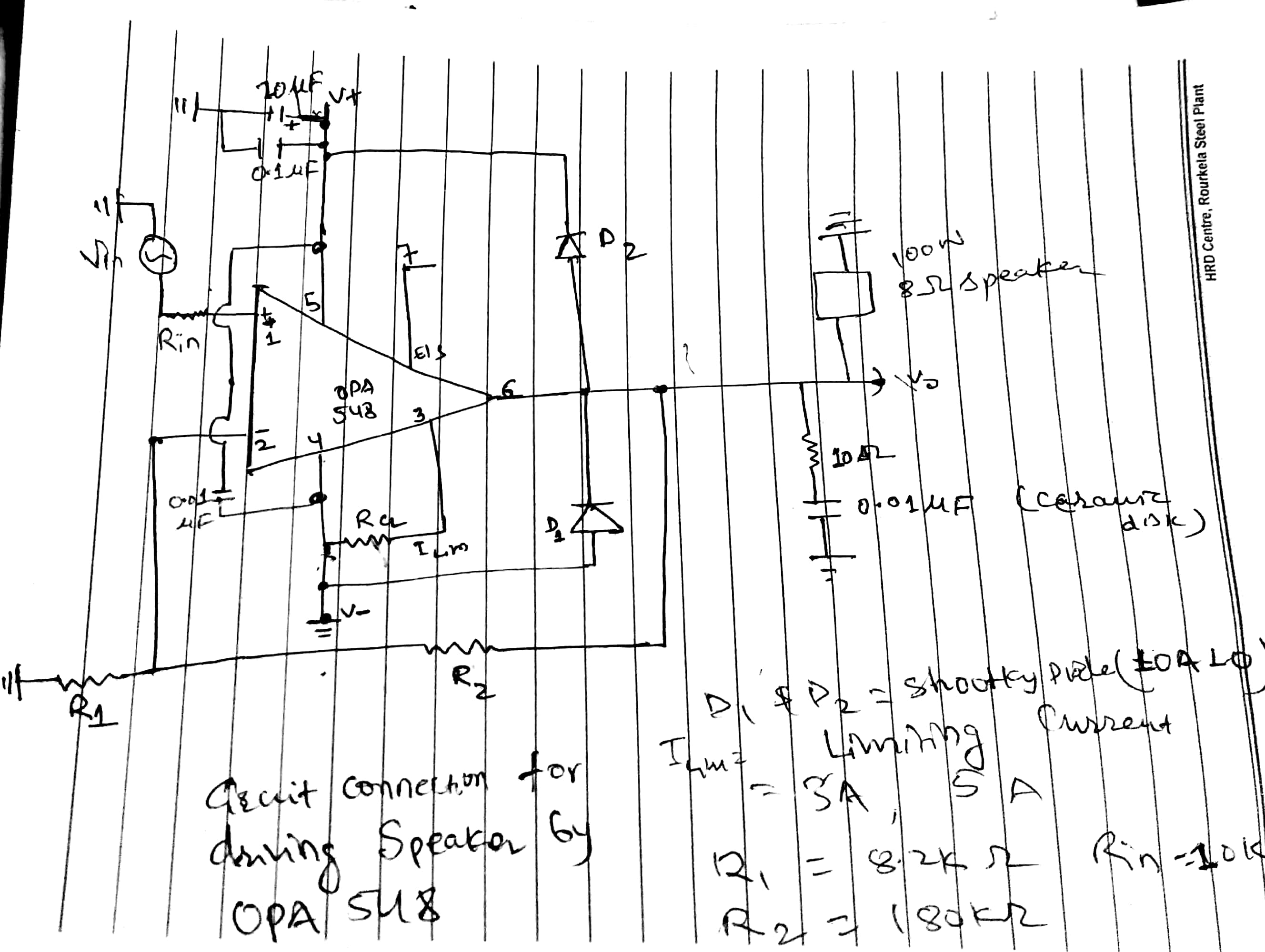

I am using OPA 548 as a power amplifier to drive a 100 W, 8 ohm speaker in constant voltage mode. Without any load,the gain is as expected.But, as soon as I attach a load to the output pin,the voltage drops drastically. The details are as follow:
Pin1- Vin = +/- 0.5 V
Gain = 23
Vsupply = 16 V(+ve), Negative terminal grounded.
Vout = 11.2 V without load, 4.4 volt with speaker
Current lim = 3A (Tried with maximum 5A as well)
Snubber capacitor- R= 10 ohm, C=0.01 uF (ceramic)
Bypass capacitor-  0.01 uF (ceramic)
Capacitor with power source- 10 uF (tantalum) II 0.01 uF (ceramic)
Heat sink with fan.Surface area-300 sq. cm with two fans(12V)
Any help will be highly appreciated.

  • Hi Dipendra,
    can you show a schematic?
    Kai
  • Thanks Kim.
    Kindly find the attachment.
  • Hi Dipendra,
    this circuit will not work with a single supply voltage, because the output of OPA548 cannot go negative. You will need a bipolar supply voltage.
    Also, TI has better power amplifiers which are optimized for audio applications.
    Kai

  • Hi Dipendra,
    what is your supply voltage? +/-16V? Is the OPA548 getting hot? What happens if you take a 8R load resistor instead the loadspeaker?
    Kai
  • Hi Kai,
    The supply voltage is +15 V.Negative is grounded. I have used a heat sink with two small fans on it.I tried loading just 8R resistor.But, still the voltage drops drastically.
    Thanks and regards,
    Dipendra
  • Hi Dipendra,
    as I said before, the circuit will not work with a single supply, if your input voltage is +/-0.5V! This circuit cannot go negative at the output with a single supply. You need a dual supply voltage. This should also show your TINA-TI simulation. If you intend an output voltage of +/-11V, take a minimum bipolar supply voltage of +/-15V.
    Kai
  • Hi Kai,
    I tried doing so.In single supply,I understand The negative part of input signal won't be available at output.But,lets not focus on it.With dual supply,I am getting both +/- at output but this is not the major cony here.The question is about decreament in gain.
    I focus again that the gain is DECREASING with addition of load by almost 3 times.
  • Hi Dipendra,
    what is your current limiting resistor?
    Kai
  • Hi Kai,
    I got it solved. The problem was current magnitude.The dc supply had current limit of 0.5 amp which was not sufficient enough to drive the speaker (though my current limit in op amp was set to 3A by 10k resistor).But,now when I increased the current limit of supply to 2A,the gain doesn't decrease.
    However,I got another problem now.When I run my speaker at frequency of 1Hz,the output waveform (irrespective of types,i.e square,sine,traingular) oscillates at a frequency of 30 Hz. This oscillation is observed for frequency less than 50Hz. Please suggest some solutions.
