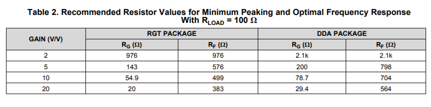

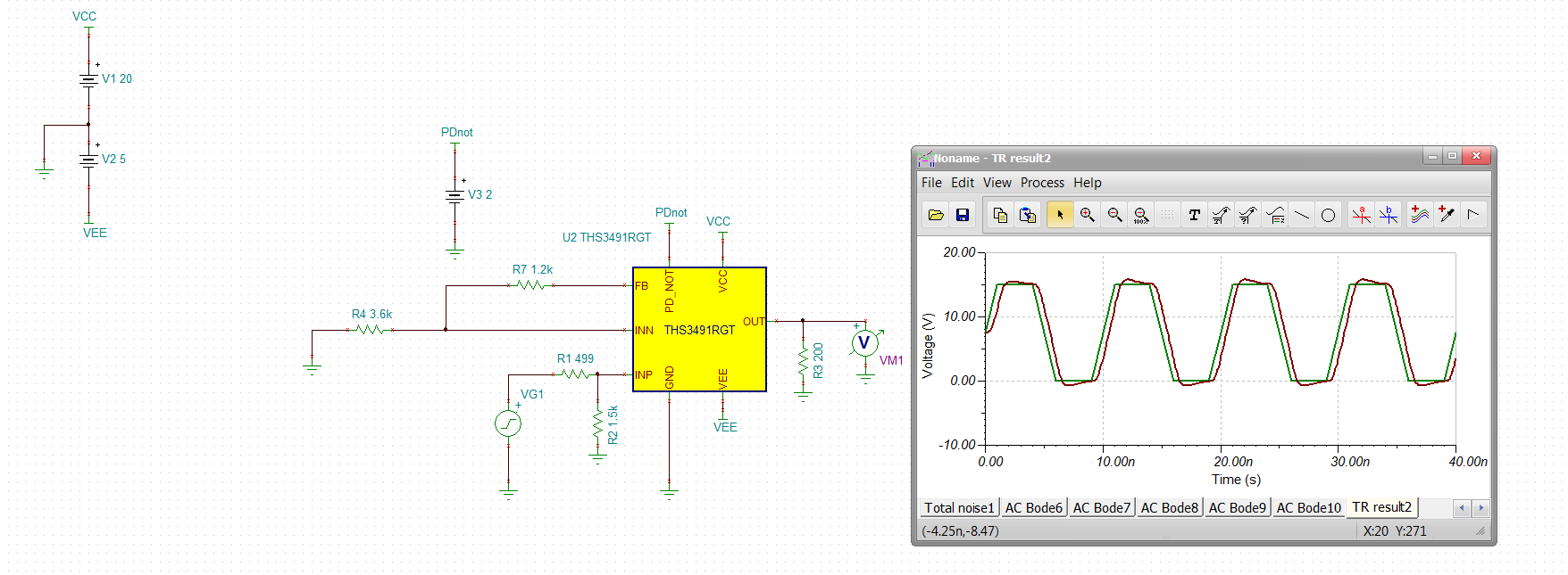

My customer is seeing if TH3491RGT can be used as non-inverting unity gain amplifier with TINA-TI. When Rg is open and Rf is 200 ohm, TINA-TI shows unstable behavior as attached. Could you please support the following questions I got from the customer?
1. Can TH3491RGT be used as non-inverting unity gain amplifier?
2. If Rg cannot be open, how is the smallest gain THS3491RGT can handle? For example, Rg=50kohm and Rf=500ohm can be possible?
3. Is there any collateral describes detail application design guide?
4. Customer would like to put high-order filter with fc=100MHz following to buffer amplifier. So 300M~400MHz BW might be required at the buffer amplifier. Is there any other better option than THS3491 for this use case?
