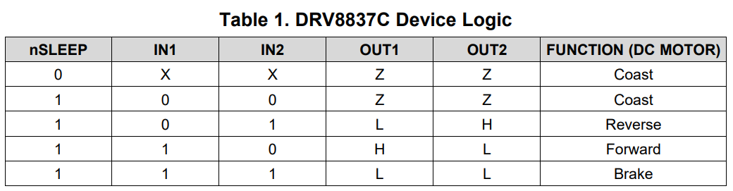

Other Parts Discussed in Thread: DRV8837C
Looking for a product compatible with Arduino and accepts a unipolar PWM from Arduino or a DAC (eg. 0-5 V) and gives me a bipolar output(+/-5V or +/-10V).
I understand it is possible to make it using an opamp but before that wanted to see if there is an off-the-shelf product.
