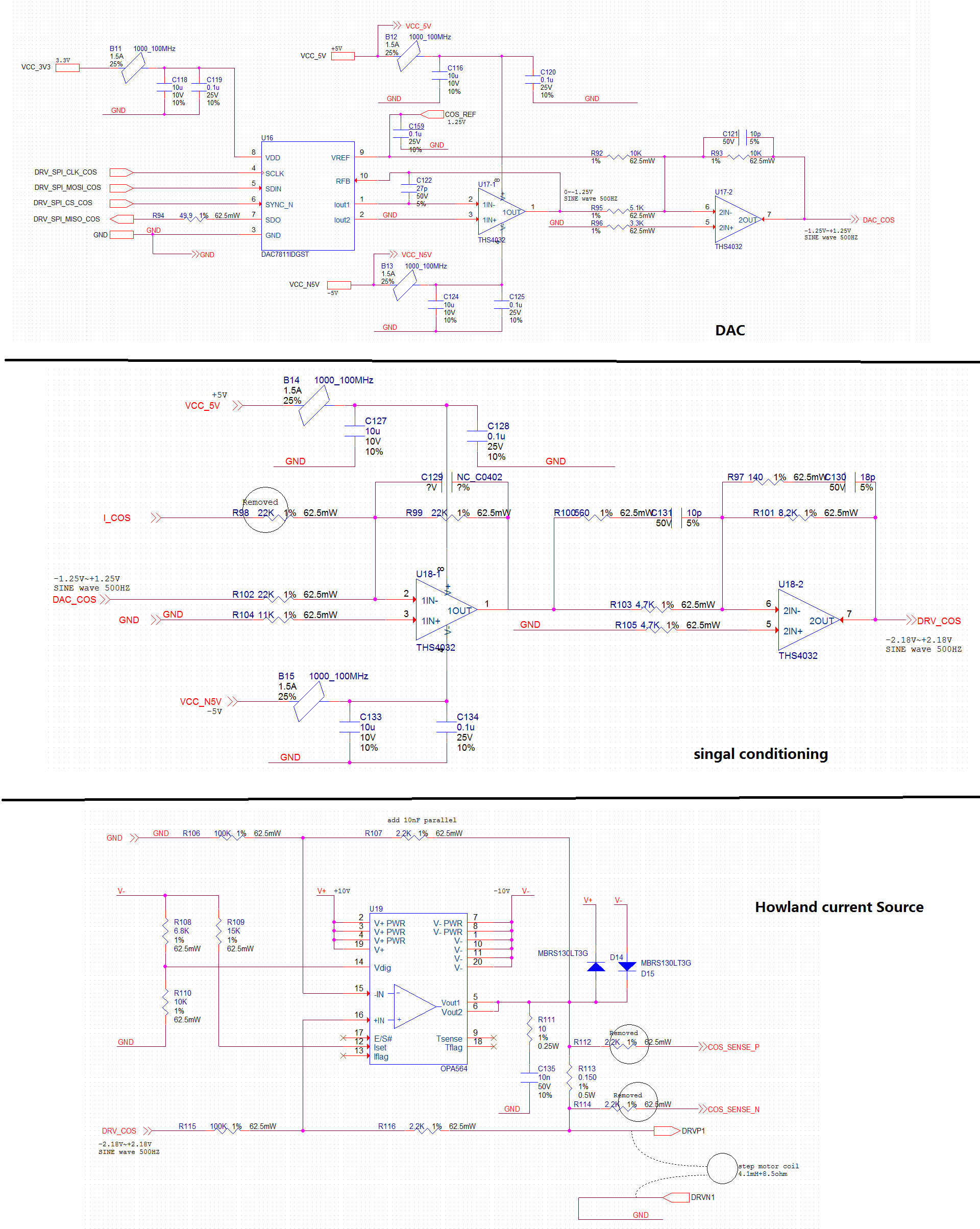

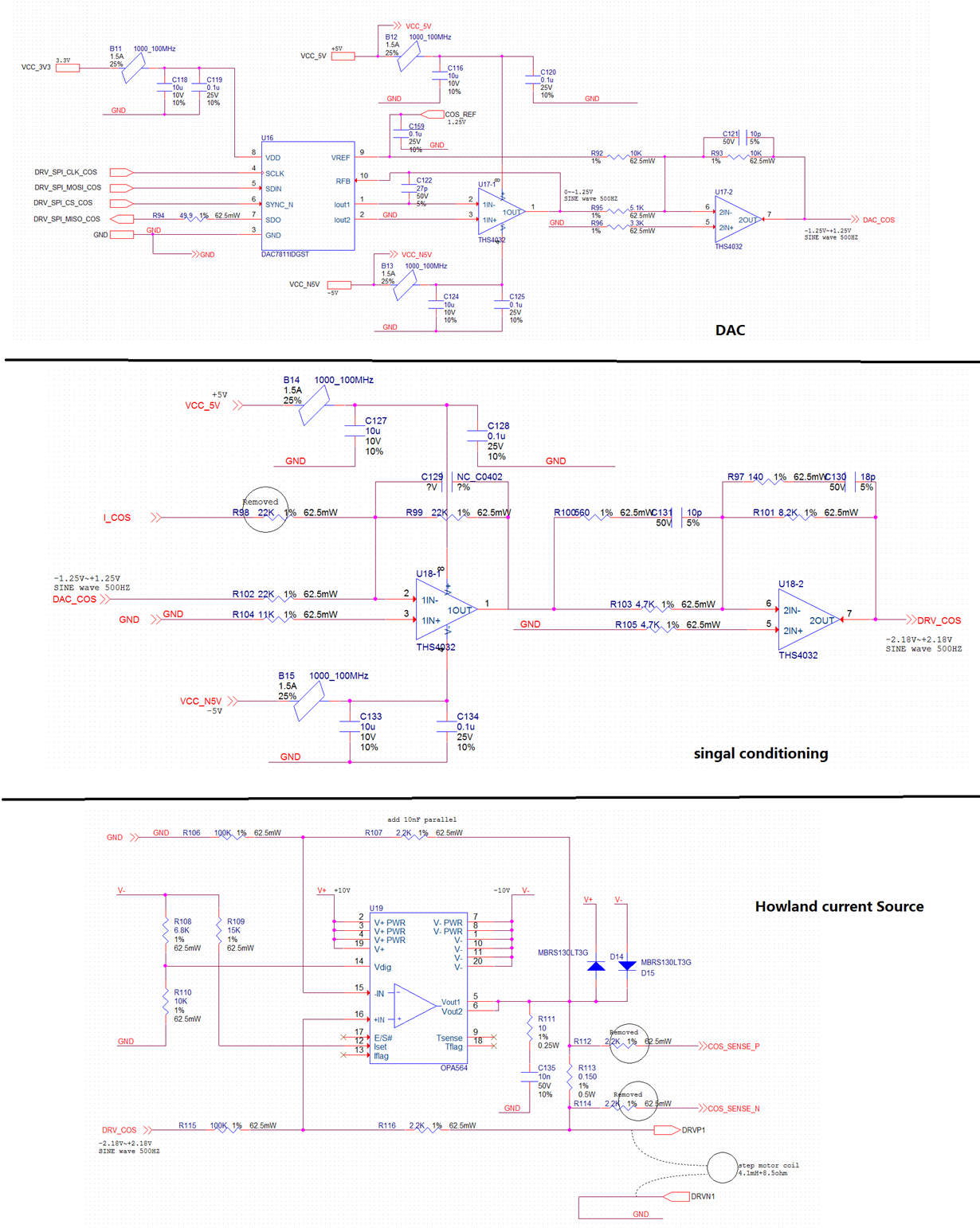

We have this step motor drive board which need to be cost down. the signal chain is as below.
DAC7811----> THS4032 (signal conditoning stages) x2-----> OPA564 (howland current source, power drvie stage) ------> motor coils
THS4032 will see max 2.2V amplitude sine wave signal amplitude (Vpp 4.4V) and max freq. = 500HZ. Vs = +/- 10V. I think it is unnecessary to use high-bandwidth amp like THS4032. SCH would be update tomorrow after my boss approved.
Two question to consult TI expert:
(1) would you pls recommend a pin-to-pin (SOIC8) Replacement device, so we can test it on our existing board?
(2) we are in pre-mass-production phase now, and already found 3pcs among 40pcs THS4032 damaged, this happens just occasionally therefore hard to identify how and when it is damaged. The only phenomenon is we measured correct input sine wave signals while the ouput of THS4032 is at power rail , +10V or -10V, and after we replace it with new device, the circuit recover working.
One possible reason may be ESD issue when debugging or mounting the board, but it is hard to ensure this, and I can not found a good way to reproduce the potential error environment to evoke the damage. Maybe an IC Failure Analysis at factory could provide useful info, but not sure how long and how much cost it would take.
